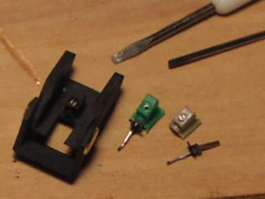

From you're description, I'm not sure what's going on. The round plugs of the 20 series are tricky. The screw head should be recessed from the top of the plug, about 1 or 2mm or so. They are painted over with a black or white lacquer. This has to be scraped off/loosened, so you can turn the screw. It should be obvious, but if it's black paint on there, it might be hard to tell. Is it possible that the screw (called compliance screw) was removed previously? Check it out again with a light and some magnification. It could be that there is no screw.
The older round plugs are harder to work. Modern styli have a brass sleeve around the back of the cantilever - the part that fits into the plug. I don't think the 15SS stylus has the sleeve. I removed one that was worn, just to try it. I probably have the old plastic stylus holder w/plug, somewhere. Send me a PM if you need it. I'll hunt it down. I didn't check if the opening for the cantilever has a different diameter than modern ones. I'll look into that and let you know. If so, the project might not be worthwhile.
$150 for a 15SS stylus seems steep. But if you consider that it's a beryllium cantilever with a nude square shank shibata, it's actually a good deal. Check out the price of a 2M Black stylus on an aluminum cantilever. I know how it is though. I paid around $200 for the 150MLX stylus. I should have tried it on my 440 first. Maybe it was paying learning dues.
I forgot to mention that the 7V stylus didn't track right on my 440 body. I got sound, but it kept repeating. This was with the plastic holder/wings. Either the plug isn't as high or somehow the holder isn't right. I double checked everything. After I transplanted it, there were no problems with it on the 95.
neo

neobop

Would you happen to know what thread Clearaudio uses for their cart mounting screws? I think it must be 2.6mm, cause nothing I have seems to thread properly. I bought it used and only got the nylon screws, which I destroyed when removing the cart.

I think the Clearaudio screws are an odd size, like 2.6mm. I have plenty of misc cart screws and 2.5 seems to thread about a mm or two and then get stuck. Metric is actually easier to work with. Many of us are used to measuring arm mounting and such in mm. We translate to inches to get a better conception of actual size.
I take back anything negative I ever said about NeedleDr. I called them to ask about the screws and they're sending me a set from a busted cart - N/C. I buy record sleeves and RCM fluid there so I'm a previous customer.
David,
The AT15/20 stylus holder will accept any AT cantilever. The offer stands, if you need it.

dlaloum
  • Posts: 710
Re: Clearaudio MM and AT-95E
« Reply #28 on: 1 Apr 2011, 09:46 am »
David,
neo
Hi Neo
that would be great actually - I think my one may be missing the screw... and I have no other obvious examples to work with.
I am currently debating between ordering an ATN13 needle so I can try out the AT20 and TK7su I have and decide whether I want to spend more on them, or whether I just bite the bullet and get an ATN20ss/ATN15ss ... or maybe get the Jico ATN20 equivalent?
I've been vacillating on this for some weeks now!
Still have concerns about compliance/tonearm - both the 15 and 20 are too high compliance for the tonearm theoretically speaking.... but concensus out there seems to be that the high compliance designs give the "silkiest" HF... and the lower compliance designs give more punch but a grainier HF detail....

David,
No Problemo. Just send me a PM with your mailing address. Good thing you live really far away. They'll put it on a jet plane and you'll probably have it sooner than if you lived in New Jersey.
You might want to consider the ATN7V. I just got one for my AT-95. It seems to be working out nicely. It's a .2 x .7 nude sq shank on a tapered aluminum.  Cu is 7 @100Hz. It seems to outperform the Jico shibata, at least to my ears. The shibata might be a little sweeter but the 7V is cleaner, faster and more detailed. The high end sounds more extended, although I don't know if it really is. It might not be the ultimate, but for $79 the cu is right and it sounds damn good on the 95.
I'll see if I still have that old 15SS stylus that went with the plastic holder. I think it still has a little life left. That's why I was messing with it in the first place. If I can find it you should be able to get an idea about its suitability. I still have an unopened ATN20SS, so I really don't need it.
neo

  • Posts: 3446
  • BIRD LIVES
« Reply #37 on: 8 Apr 2011, 12:35 pm »
I think that you are primarily talking about voicing of the stylus (primarily resonance, and damping which impacts on that resonance)
I am testing an ATN12S stylus tonight for its cantilever resonance.... if it comes up where I want it, then there will be the possibility of creating an ATN1512S. Which would be nice as the ATN12S is readily available at a good price... - but everything hinges on that resonance .... ie: the voicing
I now have the ATN440MLa mapped out - and tonight I am mapping out the ATN12Sa and the Ortofon Digitrac 300SE - If I have the time and patience maybe even the VMS30mkII
Better stay away from designating cart-tip combos that way. With AT you're likely to be talking about another model entirely, and not realize it. ATN designates a stylus. So you're going to try an AT-15/ATN12S? I thought you had an AT-20 body. Maybe you mean transplanting a ATN12S into the 15SS plastic? See what I mean?
I think voicing is using every parameter to get a desired performance, at a particular price point. The 7V is a Japanese model. It's $189 from Japanese on-line retailers. LpGear imports them. They also import some other models - ATs and the Deft carts made by Jico. The Deft is a pretty nice cart for little money. Jico makes an SAS stylus for it, but will only sell it in Japan. That's why I didn't consider it. The Japanese practice of domestic only models, puts me off, although in the US, they're all discounted and our prices are are less, depending on where you buy.
neo
dlaloum
  • Posts: 710
« Reply #38 on: 8 Apr 2011, 01:10 pm »
Heh... let me be more specific.... the AT15 & AT20 styli appear to be identical with the possible exception of compliance....
I have a really good AT20SLa body (almost perfect match on inductance and resistance....)
So I am looking at the possibility of taking an AT12Sa stylus (ATN12S) - which is one of the nicer economy shibata's around - with a tapered cantilever
And fitting it into the ATN15SS stylus plastic housing (ie the plastic housing for the stylus for an AT15ss cartridge) - which you are sending me.
The ATN15ss housing being a perfect fit for an AT20...
In any case - along the way I will learn a bit about how these styli are put together.
I did complete a characterisation of the AT12Sa tonight - and it is quite similar (not identical) to the ATN440MLa - so there is a definite "house profile".
Interestingly - putting this into excel and using goal seeking/solver to achieve as small a level variation as possible across various frequency ranges results in 2 optimal solutions for the stylus... one at minimum C (60pf) and another at very high C (550 to 600pf)
I've run the model for AT150ea, AT20SLa and AT12Sa - all using the ATN12S (AT12Sa) stylus resonance profile.

I'm dragging up this old thread to post a pic of the AT plugs. There should be renewed interest in transplanting now. The Virtuoso has been crowned king in the ongoing Audiogon MM thread.
Both plugs are CA/95 type. Only a plug from a AT-3400 series or a 95 will fit and have the correct angle to the cantilever. The screwdriver with the white handle is a regular freebie that comes with a cart. You can see that it's a little too big for the compliance screw. The screw head is recessed. About a quarter turn will loosen it enough to remove the old cantilever. It's a good idea to know about how much to tighten it after inserting the new one. You don't tighten down like mounting a cart, but you have to snug it up enough to prevent movement. The tricky part is getting the magnets aligned. You'll probably have to adjust it 3 or more times. It tends to move a little as you tighten the screw. This has to be perfect. You check it by viewing from the front. It's obvious.
Although AT has a reputation for producing overly bright carts, this is by no means true about all ATs. These sound great at 47K. Having the capability of using a stylus from another model allows voicing the cart. Put a 152 or 155LC on a 440 (transplant not required), and it doesn't need loading down.
neo
