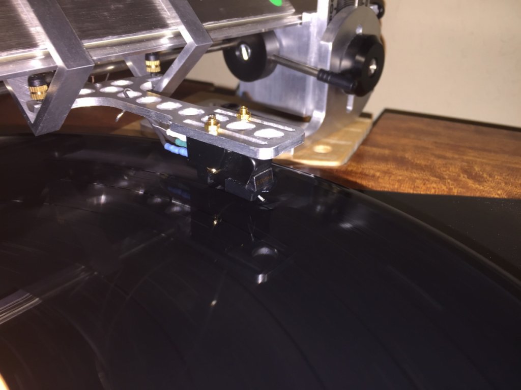

I finally got around to installing the Fidelity Research 6 SE.  All I can say is WOW!  :thumb:  Henry you were right, this cartridge is something special right out of the box.  I've got it set up with 2.0g tracking force on my TransFi arm and on the first track I was amazed at how it sucks me right into the music.  I haven't even dialed in the VTA yet--just used the same settings as with the AT 150.  Will let it run in for a few sides then do some critical listening on LPs I'm familiar with (I just got a bunch of new-to-me records that I'm enjoying hearing for the first time).
I was afraid I damaged the stylus mount pressing it into the motor body--the plastic has degraded a bit over the years, and the fit was very snug, but it finally went.  Sure wish it had some sort of stylus guard!

Glad to hear you like the FR-6SE Evan... :D
2 Gms may be a tad heavy for it? I run mine at 1.5Gms VTF.
I thought you managed to get one with the stylus guard?

Neo,
The TransFi has VTA OTF--one of the reasons I got it.  I bought it directly from Vic--it really is a brilliant design and sounds great, especially given the relatively low cost.
I did tweak VTA yesterday just by setting the wand parallel to the record.  Didn't seem to make a difference--still sounds great.

Henry,
I started at the top end of VTF and will drop it down--seems a tad warm and lush, so less force may help that.
I think you're right about the guard!  It may be in my cartridge box--need to look.

Henry,
While I distinctly remembering buying a cartridge with a guard, I don't have it.  I think I forgot to look for it when I received it. :duh:
Dropping VTF to 1.5 definitely brightens things up a bit.  Love this cartridge!  Thanks for the tip.
You might also want to try raising the VTA just a smidgen at the pivot.....
This cartridge has great 'body'.....but it needs to be massaged 'just right'.... :tempted:
