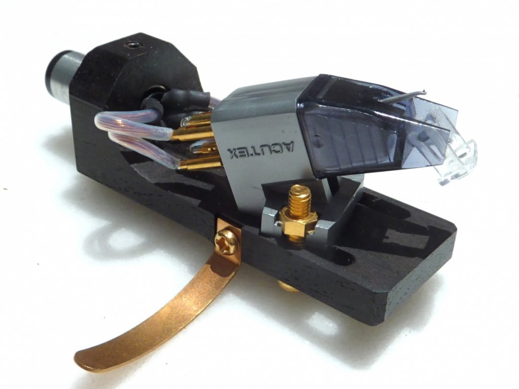

Acutex fans:
neo

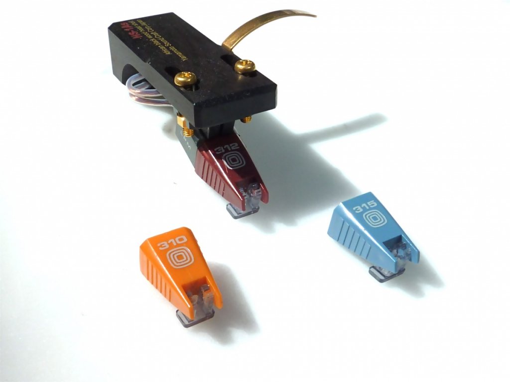

« Reply #1430 on: 2 Oct 2016, 12:36 pm »
Here are the 310, 312, and 315 in living colour.... :icon_lol:
It is hard to distinguish many differences between the three although other folk swear that the 320 is 'The One'..... :thumb:

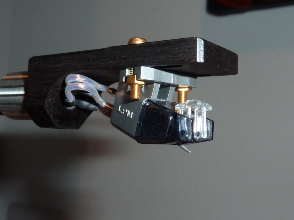

When I load the LPM 420STR however...
the clouds part and the sun bursts through with vivid clarity... :dance:
This cartridge is surely in my top 15...... :guns:

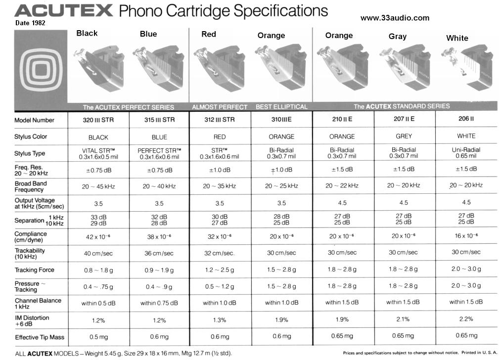

Hard to find generator specs for Acutex.   Seems that some of the upper models were 610 DC/ 2700 IMP.  Some also had boron cantilevers, but tip mass seems a bit high.  They must have bonded diamonds.
Nagaoka is said to be the OEM.  This also makes sense as Nagaoka makes most of their styli with bonded tips.
Acutex are induced magnet types, with magnets at 45° w/a piece of metal shield between the magnets.
Are some Acutex models 3 magnets?
Any info - please jump in.

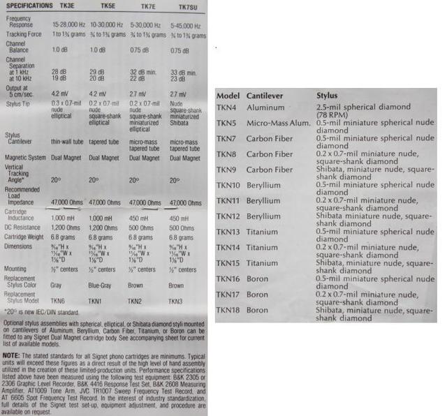

I think we touched on this in a PM.  The TK7E and 7SU share the same generator.  Check out the chart near the top of the page (72).  That's not such a bad thing.  You might find one body sounding better than the other.  If you have a digital (necessary) multimeter, you can check for similar channel resistance.  Some meters can measure inductance and you can check that too.
Not sure if you were reading this thread when I bought an old Signet MR 5.0ML ?   The body didn't sound good, but the generator is the same as a 440 (490mH), and the stylus sounds great.  But that's a modern 100/120 series beryllium/ML.  Your TK7's are older round plug types, and with that ATN20SS  coming in, you should be in great shape.

« Reply #1437 on: 13 Oct 2016, 08:26 pm »
I can not find this cartridge LPM 420STR . Can someone give me a link? Thanks...
The 420STR is a vintage cartridge that is no longer made.
You need to keep an eye out for one on eBay or even better....HiFiShark.
They come up from time to time. You just need to be patient.
Here is a LPM 412STR that is currently available
http://www.ebay.com.au/itm/381791961623?rmvSB=true
Good luck.

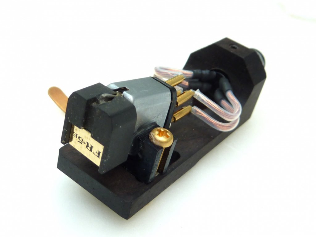

Henry,
Before I forget again, great photos!!
Don't you have a couple of FR MMs ??   Could you tell us about them?   The FR-6SE looks like the best one?
neo
Thanks Neo....

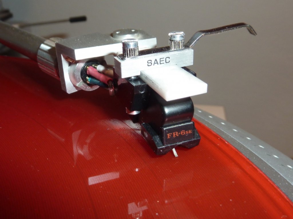

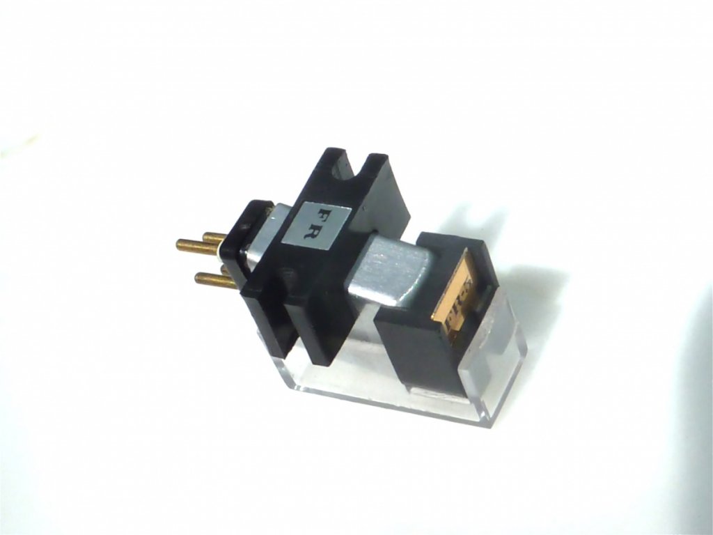

Yes I have a whole cotillion of FR MMs....
The FR-5
The FR-5E (a favourite of J.Carr)
and the best of them....the FR-6SE
Luscious and enveloping as they all are....the FR-6SE mounted in the ceramic headshell of my SAEC WE-8000/ST tonearm is one of the most captivating sounds that has filled my room  :rock:
