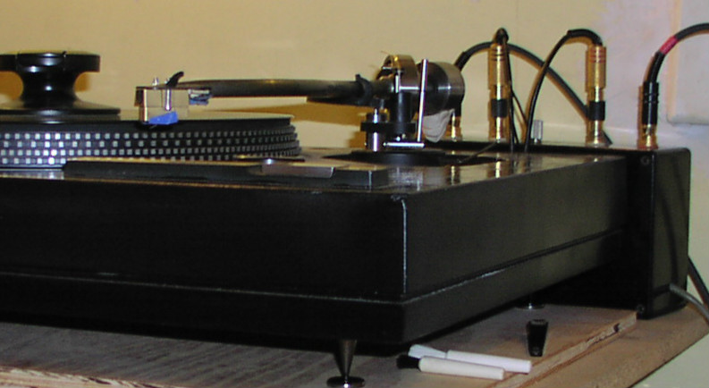

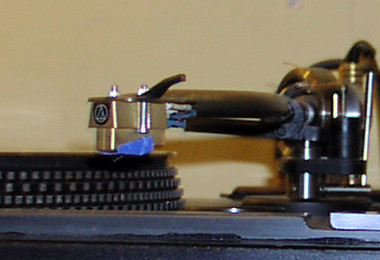

« Reply #135 on: 12 Mar 2013, 02:22 pm »
When I switched the AT15 to the Alphason, I noticed the stylus didn't seem to be seated properly, a good reason to be bass deficient.  I cleaned up the plastic trim and after some more hrs, I'm starting to get some extraordinary results. It's rather confusing because I'm using a new line stage, a JC2 clone which can sound lean in the midbass when paired with the wrong amp/speakers. The long cables I had on the Alphason arm were great with the MC I was using, but were too bright with the AT. So, instead of using an older more forgiving phono stage, I moved the AHT over, put it right behind the TT, and I could use some 1' long VDH cables and put everything under microscopic analysis, so to speak.
The AT15 sounds like a different cart with the Precept 550ML stylus. The 15/20SS normally sounds lovely, nice detail and stage and all that with a touch of sweetness in the high end, which tends to make things more palatable. It's a terrific cart if you're looking for resolution, clarity and listenability with a natural sounding presentation. With the new stylus it sounds positively live, super detailed, revealing and unforgiving. This set up isn't 100% yet, but it's getting there. I only have 50pF in the AHT and I think I could use another 50pF with these cables.  I'm running this at 47K.  Gain is set for around 42dB.  The JC-2 clone has 14dB gain, but on this set up I can get away with using a passive preamp. Lots of combos to try.
The stylus might not be entirely broken in yet. A new AT stylus might take anywhere from 3 to 8 hrs to break in mechanically. This stylus seems different from other ATs.  I had a beryllium/ML before, the 152ML.  I tried it in a low mass arm with the 440 body.  It was amazing.  I had the 440 loaded at 32K to prevent ear bleed, and I changed it 47K with the 152ML stylus. I think I would have settled on something like 42K, if I had the resistors on hand.  The PCN550ML seems to be different in the way it changed the sound.  I only have 30x magnification at the moment, but I think this beryllium cantilever might have a titanium sleeve, and the ML diamond looks bigger than the more modern ML which are so small I can barely see them with 30X.  I'll have to get more magnification.
Look how ugly looking it is, all chopped up.  I didn't like the look anyway. It's only a stylus and at least it's not broken. This is normally my "B" set up:
neo

« Reply #138 on: 19 Mar 2013, 12:44 am »
I guess the cart doesn't look so bad.  I wish it had a removable top
I measured the resistance at around 1.1K ohm.  Impedance is supposed to be 1200 ohms, and output is the same V as the PC-440. This is getting interesting.  Maybe I will check it out
neo

« Reply #139 on: 23 Mar 2013, 11:25 pm »
Neo- I have a PC220 which may have the same skirt as your 550. I trimmed the side skirt back far enough to fit flush against
the top of the black part shown in your picture. Since there is still some side wall, the stylus is stable and won't move from
side to side. In addition, it is still usable in any other round plug body, including the Precept. My impression is the stylus is
probably lower compliance than the AT12 but then again, I have not played it for awhile.... my recollection is it sounded
more like the AT7V than other AT's but then again my memory is sometimes faulty....It is a perfect fit with about 75% of
the sidewall gone... Just played it and it has more "shimmer" than the AT7V and sounds quite good on a Dual CS450 with
the modern plastic headshell -different sound than the Ortofon MC-10 Super I took off but still very pleasant.
