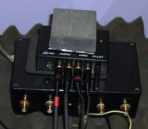

I wanted to check out Vista and Z1E so I set it at 47K/100pF/40dB to compare to Revelation phono section.   If there's one thing the Revelation II does right, it's the phono and I was surprised when Vista seemed to beat it easily.  Shades of my AHT??
Lets see how it can drive the amp through a passive preamp.  I upped the gain to 50dB and removed the caps.  I have a 1m Ultimate tonearm cable + the 100S internal wire for capacitance.  Enough?  Apparently not.  For a couple of minutes Vista sounded remarkably like AHT.  It was blowing my mind until it started getting congested and went into oscillation.  I'm pretty sure this was due to no caps.  I put 50pF in there and it seems to be cured.
I've since reset to 40dB gain and I think 100pF was better with the Z1.  I'm awaiting a shipment of resistors and caps so higher capacitance will have to wait.
Vista atop AHT with a lead brick holding it down.
neo

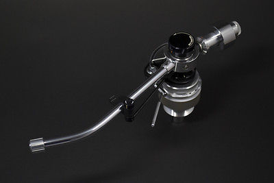

On another front, I picked up a Victor UA7045 arm.  She is a beauty babe, nice and curvy w/big skate knob and removable headshell.  Maybe a tonearm should be considered male, in which case he's strong and rigid.
This isn't my arm.  Mine is in surgery - should be fine.
