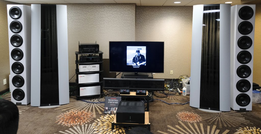

Had an excellent demonstration of this FLOOR / WALL MOUNTABLE DOLBY ATMOS 7.2.4 ALL ELECTROSTATIC speaker system with 2 of the TEKTON DESIGN LINE ARRAY subwoofers @ THE SHOW in SOCAL, June 25!
The system was shown with the ATMOS speakers on stands (NOT THE MOST ELEGANT INSTALLATION, as the hotel venue rules prohibit wall mounting) and TEKTON DESIGN LINE ARRAY subwoofers.
1 Pair of MODEL 35 Full Range ESL Panels as Fronts,
1 Pair of MODEL 15 Full Range ESL Panels as Rear Surrounds,
1 Pair of MODEL 5 ESL Panels as side surrounds,
 combined with the MODEL 3 ESL Center Channel and
4 (2 Pairs) OF THE MODEL 1 ESL DOLBY ATMOS HEIGHT Speaker Panels
are used to create this sensibly priced Ultra High Performance Multichannel System!
The system has a cohesiveness combined with ultra high resolution offered only by the finest electrostatic speaker technologies that does full justice to HIGH RES IMMERSIVE MULTICHANNEL AUDIO music and movies.
The inner detail from music and movies that other speakers gloss over are rendered with focus and precision with these stats!
