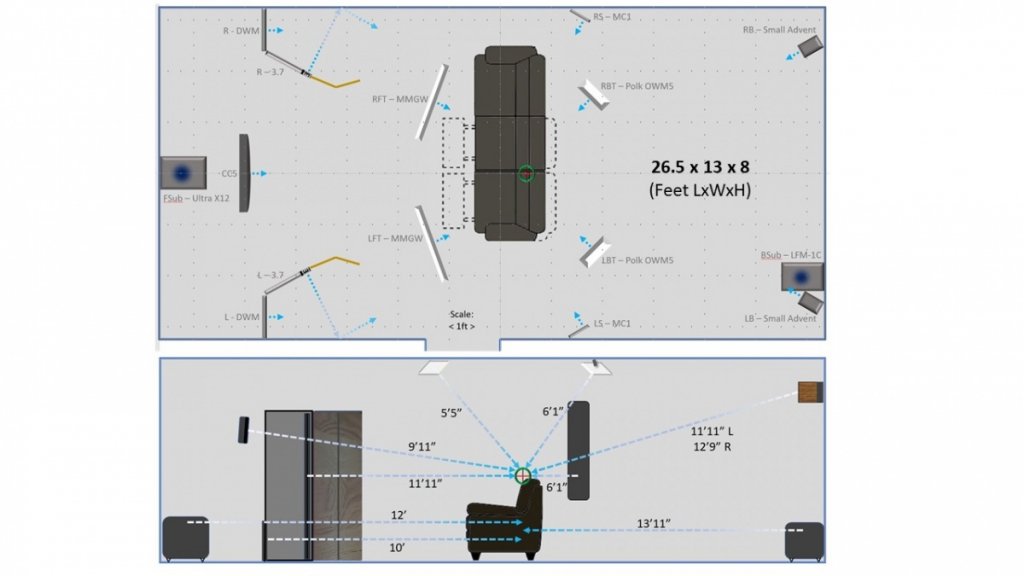

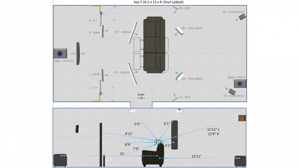

Hi Everyone ... new to this forum.  I've been experimenting with speaker positions and home theater configurations in my system and recently added Dolby Atmos top speakers.  Here are two configurations that I've tried so far.
