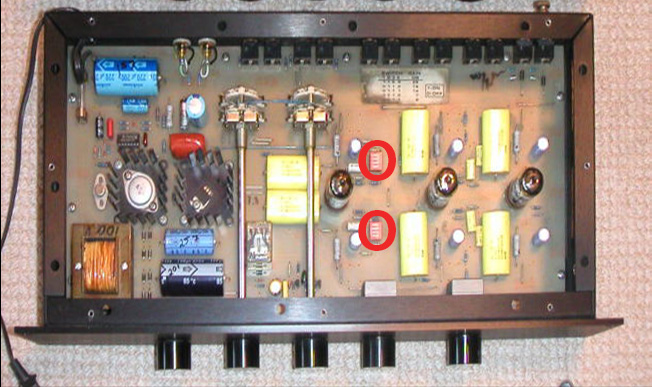

not all RM5's had the adjustable gain stages. my RM5Mk2 did but the later versions did not. the reason was that they sounded better without it. do not know what the gain was set at for them.
Photon46
Re: rm5 preamp
« Reply #21 on: 9 Jun 2014, 08:05 pm »
My Rm5 MkIII definitely has adjustable line stage gain and I have seen pictures of the circuit board in a MK. IV that has the gain adjustment dip-switches as well. The MK. IV I saw had different style switches than my Mk. III. The Mk. IV has a detachable power cord and a switch to turn off the phono stage tubes, earlier ones do not.

Photon46/rbwalt-
Where are the dip switches that are used to adjust the gain in these preamps? On the back? Inside?
I havent seen any pictures where I can locate where they are.
Ericus Rex
Re: rm5 preamp
« Reply #23 on: 9 Jun 2014, 08:30 pm »
Google Image "music reference rm 5" and many internal pics pop up.  The DIP switches are between the left and middle tubes.
In addition to what Photon mentioned the only other differences I know of between any of the different versions are number of inputs, labeling of inputs on front panel, and number of outputs.  The circuits themselves are essentially identical, iirc.
Photon46
Re: rm5 preamp
« Reply #24 on: 9 Jun 2014, 11:10 pm »
    The dip-switches are surrounded by red circles. Later model RM5 IV's I've seen pictures of have red switches instead of white. Hats off to member 6BQ5, I used a picture he posted earlier on Audiocircle.
The gain was set for 18 dB. The switch can be added to any RM-5.
