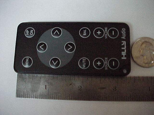

I was tired of trying to find a good sounding SS preamp as a backup or for a second system. I took a leap of faith and ordered one of the new Hlly AMK pre's from China. Total cost DELIVERED was $120.00. I have had it in my system for 3 days now and I cannot believe something this cheap could be so well made and sound so good! :o Yes the unit has some flaws, but $120.00 !! Best part is that is has a FULL function tiny remote control. You can switch between CD, Aux, Tuner, etc. Also has mute and 2 step volume up/down and 1 step volume up/down and balance L/R. The sound is VERY nice across the board. I found that at high output levels, vocals can get a wee bit edgy, but $120.00 ! Anyone else have one yet? Maybe a tweek here or there? Worth looking into for a second system. Just My 2 cents! :thumb:

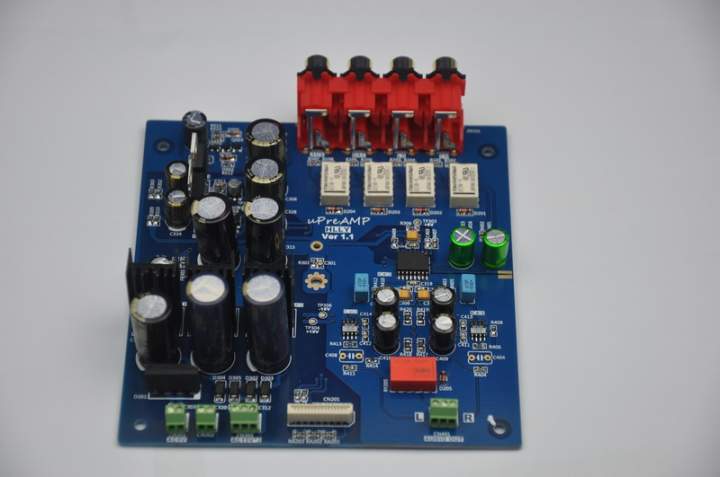

From eBay seller, ns_fm_transmitter's ad:
http://cgi.ebay.com.sg/HLLY-AMK-II-Pre-amplifier-AD797-CS3310-Included-/330475311645
Also there is a photo of the circuit board, but none of the remote.

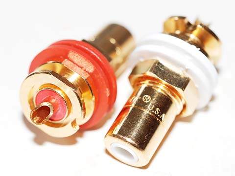

Of course the input RCA's are close together and it is a bit hard to use locking RCA's on them, just tight fit. The output RCA's seem to be pure copper and say Made in USA, very nice.

Hope this picture of remote comes up.

B1 is a buffer so don't know if they are comparable.  Highly doubt it sounds as good frankly. Hlly products have been soso quality from what I've read. They pay attention to DIY trends and put out stuff based on that. Still for the money its cheaper than thepga 3310 kits and you get a nice enclosure to boot.  Skeptical about the copper RCA made in USA though.

I checked the "copper" output RCA's and found that there are gold plated CMC units. I found them here:

Well I had some time on my hands and took this preamp apart. I found that the unit uses AD797 opamps, not bad. I also found 2 small value caps connected to the opamp legs. One on each channel. They are the blue caps on the board and read 470pf @ 630 volts. No brand on them. I had a couple of Wima 680pf FKP 100 volt caps lying around, so I figured why not swap. I did the swap out and the results were 10 fold. Now the preamp has much more depth and the soundstage has improved. Also the "grain" is almost all gone in the vocals. I can now play it at louder levels without my ears bleeding! It sounds much "warmer", I dare to say more "tube like". It was the best 80 cents I have ever spent. This unit is a real sleeper ! Just wanted to share the results. You can take a decent sounding unit and get it sounding much better for next to nothing!  :thumb:
