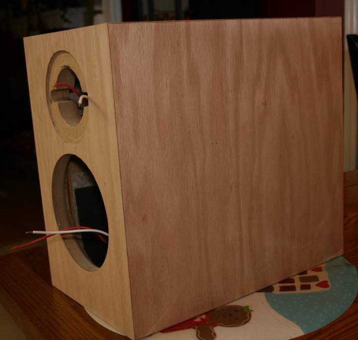

« Reply #14 on: 24 Dec 2010, 01:06 am »
Here are a few more pictures.  I was able to finish one of the cabinets earlier today.
Here is a closeup of how I installed the the magnets to the baffle that will hold the grill.
Drilled the hole with a forstner bit.
Used epoxy to keep it there.
All four installed on the baffle.  They are flush with the board surface, so the veneer will cover them.
Here are a few with all the veneer installed.  I used red oak.

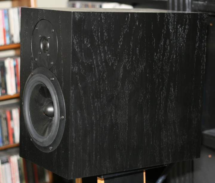

« Reply #16 on: 2 Jan 2011, 04:40 am »
Here are a few pictures of the finished product. I learned a lot on this build, so the next one should be better.
They sound very good.  I think they are an incredible value.
Thanks Danny.

Re: First build: X-LS mini-monitor
« Reply #17 on: 2 Jan 2011, 12:07 pm »
 Your finished speakers look great. Nice job!  :thumb:
What type of damping material did you use inside?

django11
  • Posts: 1099
  • Canuckistani
« Reply #19 on: 2 Jan 2011, 01:54 pm »
Nice job!
 I always like the black oak and it is surprisingly easy to do.
