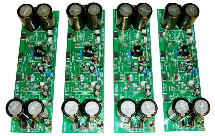

Folks,
I'm furiously assembling NAKSA 100s now.  Here's a piccie of four all complete, awaiting mounting on their heatsinks then testing:
These NAKSAs are premium, pricier versions with Nichicon Gold Muse caps;  regular NAKSAs have the Nichicon KZ.
This batch is ten;  all are accounted for, all overseas.  (Mind you, from Oz, just about everywhere is overseas!!   :lol:)
I cannot begin to describe how happy I am with the sonics of this amp, might even call it La Stupenda!   :roll:
Hugh
