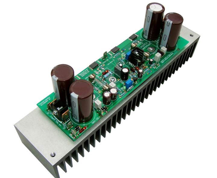

It's here, folks, have a gander!!
Sounds sensational, I'm very, very pleased.  A NAKSA 70 on steroids, no less.
One channel to one heatsink, with integrated power supply:

Congratulations Hugh.
Big compliments for the design and buildquality. Great picture too. It looks really marvellous.
This might be a serious sonic competitor for your highly praised Lifeforce amp?
I would love to hear the Naksa100! Who knows...

Thanks Hans - the picture is taken in bright sunlight from the right angle with my old Sony T200, and reworked with PhotoShop to look like something you'd want to own!!   :wink:
Perhaps I should send you one, and if you like it, you buy it......  and if not, you pass it on to someone else??    :lol:

Jens,
You are on, will get cracking.  I have a pair ordered from Slovenia, too, and one locally here in Melbourne, so I'm going to be a busy boy.  After taking my daughter Soraya to the airport this morning, and spending some time on the Maya this afternoon, I am commencing construction of six of these NAKSA 100s.
The one photographed has now been playing for six hours, and idling overnight.  All measurements are immaculate, I'm delighted with the robustness, too, and the sound quality is astonishing.
Thank you for your interest, your confidence, and your order!

As a general rule, I like to use a transformer of at least twice the rating of the max rms power of the amp into 8R.  This is only sensible from a headroom POV.  This places the minimum rating at 400VA, so 425VA would be optimal.  I suggested the higher ratings of 500VA and 600VA because toroidal trafos are made in common values of 500VA and 625VA and DIYers are well known for overbuilding.  I will confess to early auditions using a single 300VA, and with my 8R VSonics I can say that this was entirely adequate.  However, I really would prefer a minimum trafo size of 400VA, with 425VA the nearest preferred rating that is commonly available.
How big is each unit? Inches please? i presume soldering is in order here. So it's the AC, the RCA and Speakers to wire up, and of course some way to turn the amp on or off. Or are you providing connectors you just solder to them and go? Since I can't see your pics, then is the heatsinks included too?
Each unit is 300mm (11.95") long (heatsink length), 75mm (2.95") tall (fin height), and 105mm deep (4 1/8") deep (top of filter caps to tip of fin).
The only soldering necessary is input hot/cold (pcb pins) and the flying lead connections to the binding posts for the speaker.  Speaker connections to the board are high quality pcb spade connectors, all supplied with the module.  Connectors are also supplied for the transformer secondary connections to the module (four, two for each secondary).  All connectors are crimped, not soldered.  It really couldn't be simpler.  The mains connection from transformer to IEC socket, including switch, are NOT supplied.  These too are simple but will require soldering for maximum safety and reliability.
Two heatsinks are supplied with two single channel modules, one for each amp channel.  Each high quality, cast alloy sink weighs 1.105Kgs, or just under 2.5 lbs each, 5 lbs plus the weight of the modules.
What voltage or range of voltages and current rating for the Trafo  for the two secondaries should I be looking at?  I'd figure another couple hundred bucks US for Trafo case and various wire and connectors would finish this out.
Speaking of wiring, are you suggesting two or three prongs for the AC mains? Are you using a captive cord, or IEC type?
I think that rounds it out for questions.
For a 425VA toroid, at the 35Vac secondaries specified, this corresponds to a 6A rating for each secondary.  For 500VA, this increases to 7.15A rating.  Your estimate of around $200 is about right!
I suggest a three prong IEC, so that the case can be power earthed.  The modules both have provision for a chassis earth as well, recommend ultra-safe practice.  The chassis earth is also a press, pcb spade connection, with no soldering.
