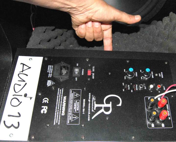

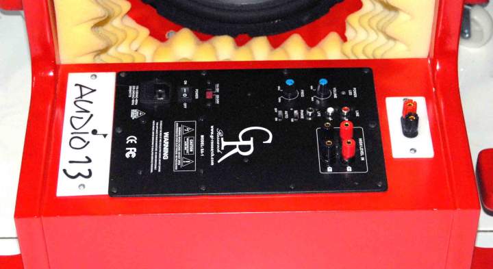

Hi kp93300 and all Audio Circle members.
Here are pictures of the SA-1 in my two pairs of V2.
All my SA-1 are attached to the V2 enclosure, I left intentionally one side open, it's where you see my finger.
If your SA-1 are in a seperate box, I would recommend some cooling slots at top and bottom on two sides. 2 X 20cm. (1" X 8") If you have any curious or exploring children around the house that can poke their fingers in the holes, make them smaller, but increase the number of slots.
With a Vietnamese ambiant tempreature of around 30C+ in the house, they do get hot if you drive them hard, but never to a point where you can't touch them.
I hope that help.
Don't forget to post some pictures.
