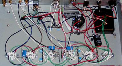

What I was trying to say from the beginning post is this: People will find a greater degree of improvements with circuit upgrades than with component upgrades. This goes for my equipment and I should not have generalized that statement.
Amps & preamps can be made an infinite amount of ways.  Different designs will have different component sensitivities. My gear has always been sensitive to power supply quality as well as the grounding architecture.
Now that you know what my playback systems consist of, it is a good idea to examine the inside of an amplifier. You might have noticed that it looks sparse. This is a completed amplifier.  All coupling caps are the most advanced polypropylene and have been reduced in size by 25%. Our power supply is based on a 1950's architecture which relies on a multi-step filtration system instead of banks of huge electrolytics. The efficiency of the ground system is a large factor in how well the power supply works. This amp uses a power transformer with a shielded secondary and eliminates allot of noise which can be induced from the mains. AKA: Isolation transformer. On top of that, a wide copper band surrounds the core to reduce/eliminate radiated EMI.
Although there is more to PS design, electrostatic shielding and a copper hum reducing band is a good start. My own parafeed headphone amp/preamp uses similar ideas with a choke input power supply  :thumb:
Anand.
