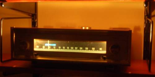

A "new" acquisition, a Sherwood S3000-IV.
A bit bass-shy but it sure sounds nice otherwise and has surprisingly good reception even without an antenna hooked up!
a properly functioning sherwood tubed tuna will not be at all bass-shy - amhik.   :wink:  though it might cost more to refurb one of these sherwood tunas than the cost of the tuna itself, it's worth it, cuz it's not that the refurb cost is so much, it's that the sherwood tunas are so relatively inexpensive.   8)

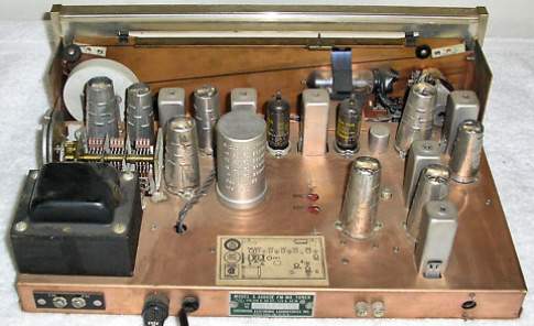

I'm going even further backwards with a Sherwood S3000-III tuner replacing a Carver TX-11a.
The Sherwood is fresh from a check up at the shop and it sounds really nice and has surprising reception, too.  I'm picking up a jazz station, which is coming in crystal clear, from Washington, DC which is a good 125 miles from me.
« Last Edit: 24 Dec 2010, 04:52 pm by SteveFord »
