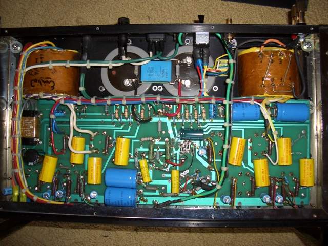

Hi,
I don't mean to hijack this thread, but I do have some VTL questions.
I recently bought a pair of VTL MB-225T's.  They were originally manufactured in January of 1993, and update to 6350 phase splittes, and other updates in 2000, by VTL.  (I bought a TL-5 from the same era, variable feedback adjustment - no manual).
These amps were designed with the EL34's.  The circuit board has a label of MB 350.  I do have the owner's manual, but it is VERY rudimentary.  I would like to better understand the tube layout.
Are the 8 output tubes paired front row to rear row, left to right in each group of four, or left bank of four to right bank of four, for push/pull?  :scratch:
I appreciate any response.   :)
Bruce

I have the same question as Bruce. Each of my VTL MB-125 monoblocks uses four power tubes marked 1 through 4. Tubes 1 and 3 are in the front row, and 2 and 4 are in the back row. Are the push-pulls pairs 1-2 and 3-4, or 1-3 and 2-4? Hopefully someone can help us out.

Ulysses,'
I can't speak to the arrangement in your amp, but...
The Manley designed (Dave 225,240,200,etc), and refined (Eveanna 250, 500) are arranged so that the tubes on each side of the mono blocks are in parallel.
For a 225, four to the right, four to the left.  For a Manley Neo-Classic 250/500 five to the right, five to the left.
If one tube in the quartet or quintet goes bad, you can take it out and still use the amp.  As one approaches clipping the side with one less tube would clip sooner.
 :D

bruce.weiland
Re: EL34 tubes needed for VTL MB225 Amps
« Reply #35 on: 6 Jan 2011, 03:21 pm »
Ulysses,
You are welcome.
If you turn the amp over and remove the bottom plate, it will probably be clear from the circuit board traces, which tubes are in parallel.  :)
You can see the traces running to the left and right to the tube sockets in this bottom view of one of my MB-225t's
Bruce
ulysses
  • Posts: 59
« Reply #36 on: 6 Jan 2011, 11:57 pm »
Thanks for your help, Bruce. I previously looked at the traces/wiring of my VTL MB-125 monoblocks, but I don't know enough about tube circuits to understand how the tubes work together. It's embarassing for me to admit this because I'm a hardcore do-it-yourselfer.
