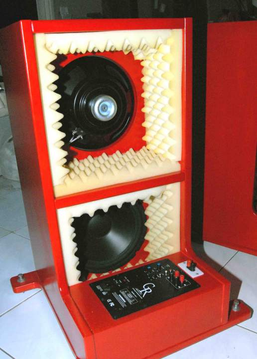

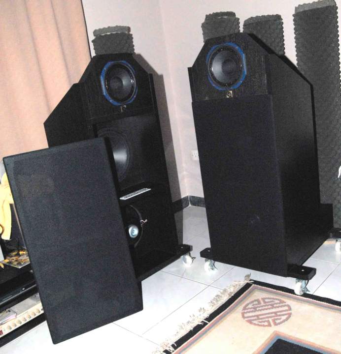

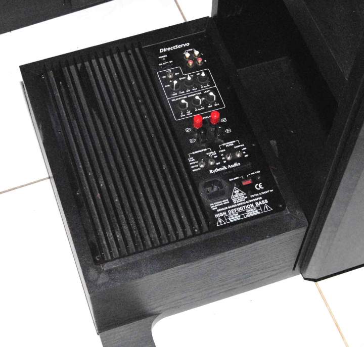

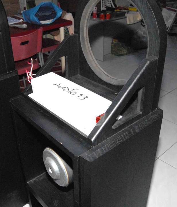

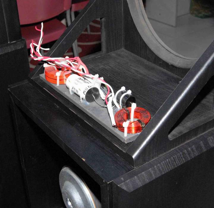

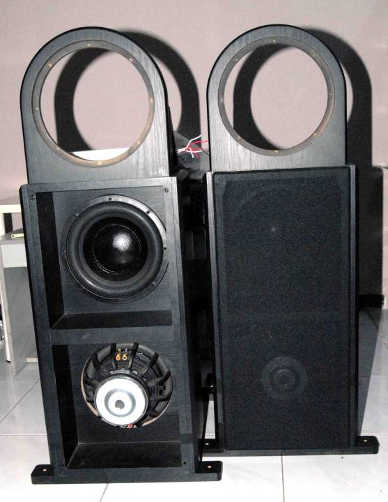

Here's a few pictures of what I am doing these days at this end of the world.
I am modifying my V1 according to Danny's recommendations.
I have moved the Rythmik amplifier away from the crossover to avoid induction.
Before it was on the top near the PAudio driver, now it's at the bottom.
The crossover is now away from the Rythmik amplifier.
I got made a plastic cover to hide the crossover, I will check if it resonnate.
I have double the sides with an extra 3/4" MDF board, I have lowered the PAudio driver, all the sides are now 1-1/2".
I got made by the cabinet make some grills, however, he will have to add some fasteners, because I am afraid it will vibrate.

While the cabinet maker was at it, I also got some grills made for my V2.
...and for my V2 Ferrari red !
I have put temporarely some foam that no AC members  like !
I will finish with a picture of my living room, dining room, entrance hall, warehouse and workshop all under the same roof...
