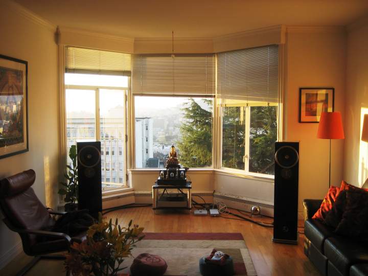

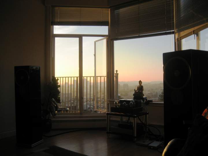

Here are a few pics...I also posted under the Acoustic treatment circle......any thoughts appreciated :D

Morgan - Before you buy new speakers try listening with those blinds closed and take that large picture off the wall thats catching the early reflection of the left speaker. If there is any other glass in the area try covering it or moving it.   Scott

Morgan,
Great photographs and a wonderful view.
Have to say the Zu Essence speakers look really special in your space.
Pretty neat having the Melody framed up top with the statue! Balance - symmetry - tube peace!
Have you considered heavy cloth blinds?
Realize that you want to keep the view, but heavy cloth will work well to take the glass out of the equation. An easy fix and a livable solution, at least, once it is dark outside.
- David.

« Reply #18 on: 12 Nov 2010, 06:19 am »
Morgan
very envious of that wonderful view
having a 13 by 50 room
with a nice view and reflective windows
why not try a long wall nearfield setup
I have a 15 by 27 room and it works great with the speakers along the long wall
you won't hear as much side wall effect
it opens up your wonderful view even more
and have the sweet spot on the sofa to the right in your photo
best audio wishes whatever speakers you choose
the salks will disappear nicely and allow the music to fill the room
