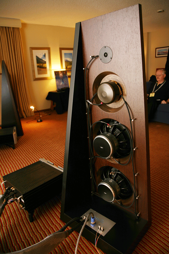

Here's that mega buck 6 figure speaker from the  Lotus Group:
Interesting how they support only one side, in a mirror image. Any thoughts why?
Love the front view, but don't think my carpenter skills can take me there.
mcgsxr
Re: AE IB15 Open baffle sub experiment
« Reply #23 on: 24 Oct 2010, 12:50 pm »
If I were guessing about why the mirrored inner walls only, I would suggest that they needed a support of some kind, and that only having one on the inside delays when the waves from each speaker will reach each other, towards the listener in the middle.

Rudolf
« Reply #24 on: 24 Oct 2010, 12:55 pm »
Here's that mega buck 6 figure speaker from the  Lotus Group ...
Because those mega bucks are acquired by eye - not by ear. Most every aspect of the back side design is telling you that. Such loudspeakers are not bought with brains involved. :roll:

Saurav
« Reply #26 on: 25 Oct 2010, 02:32 am »
My guess: to increase effective baffle width around the woofers and add some extra structural support, without generating too many cavity resonances (which might happen with 'wings' on both sides).

John_E_Janowitz
  • Posts: 28
    • www.aespeakers.com
« Reply #28 on: 2 Nov 2010, 05:36 am »
Having the brace/wing on only one side has the same effect as offsetting the drivers on the baffle.  You are essentially extending the baffle on one side but not the other.  Centering drivers on the baffle gives you the most output on the low end.  Offsetting the drivers about 1/3 will smooth the response the most.  It's much the same as offsetting a tweeter on a baffle to minimize the baffle step/diffraction effects.
If you have used The Edge to model, do one with the woofer in the center of  baffle. Then shift the woofer around.  You'll see the big bump right before the rolloff comes down as you move the woofer off center, but the following dip above it also comes back up.
John
