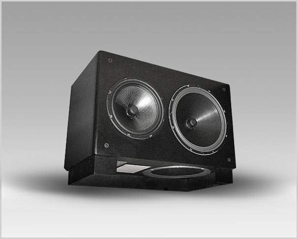

The VMPS LARGER Sub began life as a Low Frequency Musical Sub for those who wanted Low Bass, with the delicacy and harmonics of their mains.  Early on, the Larger was in what we now call the "HIGH BOY" cabinet, and was most often mated with exceptionally musical speaker sets like the old Quads and early Magnepan speakers.  It worked well with them since the large woofers produced the lowest frequencies, while the shorter throw reduced distortion and hang to allow for some incredible detail and harmonic overtones missed by most subs.
Later the sub cabinet was redesigned to what we call the Low Boy.  The Low Boy was also named the "NEW LARGER"
So we often speak of the LARGER somewhat generically, but it officially was the High Boy, and the NEW LARGER is the Low Boy
