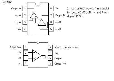

Thanks for the link! Only after looking at the standard pin-outs on single and dual opamps (lacking actual schematics) did it truly reveal itself as a Mad Hatters Tea Party.
I was trying to be nice, Paul  :wink:
I would not suggest that anyone follow Doug's switching of single op-amps for duals or the other way around. As Occam's diagram shows, they are not compatible. The single op-amp would be running off of just the negative supply with the output signal going through the feedback loop. Half the input signal from the DAC chip would be missing.
In fact, if you tried to use a dual in the single op-amp position, there would be full rail voltage on the output. It is only because there is an electrolytic coupling capacitor in the solid state signal path that changing the op-amps out didn't cause major problems. If that cap failed, or if this change was tried in one of my modded units, you could blow your speakers.
Doug's suggestion of particular brands and models of op-amps are fine. I cannot stress strongly enough that you do not swap singles for duals or duals for singles. If you try that in a modded EE DAC, you will be on your own. I will not repair the resultant damage.

I believe the AD8620 as a proper single opamp must be a misprint, with the author actually using the AD8610, a single opamp with the appropriate pin-out, as opposed to the dual AD8620, which would, in technical parlance, go all hinkey, and possibly, let the smoke out.

Hi Guys, the NE5532 and its sub(dual) and NE5534 and its sub (single) are not compatible to each other. If you plug in the dual opamp to the sigle opamp place, and vice versa, it may damage your DAC.
Cheers !
