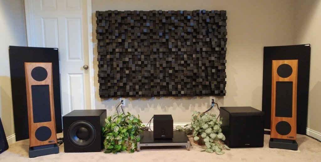

Mike, what amp are you using now?  Your last photo showed an AVA 400R I believe.
It's a Bryston 4B3. I like it a lot. Great match for the Janszens!

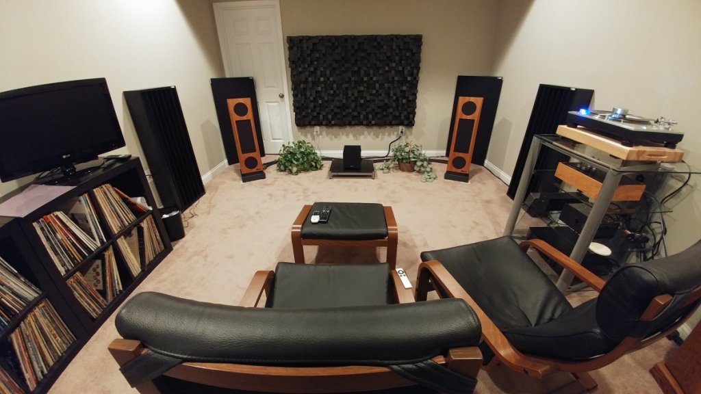

Other changes were moving the subs to just behind the listening chairs -- this got rid of a room null at 40 Hz -- and supplementing & rearranging acoustic treatments. In particular, the two GIK Alpha panels on the front wall are new, while two Vicoustic diffusers were moved from the front to the side walls (one seen on left).

Are those diffusers made with wood blocks? If so, how much do they weigh?

Room looks awesome.
Thanks! The diffusers are by Vicoustic and made of EPS (= styrofoam). So they are pretty light. An entire assembly (two square diffusers glued to artist's stretcher strips, with Dynamat on the back for added damping) weighs about 15 pounds (7 kg), I estimate.
The Dynamat is needed only because the diffusers aren't glued directly to the wall, which would damp them better.
Wooden diffusers are beautiful, but the cost is far higher -- more than I can justify.

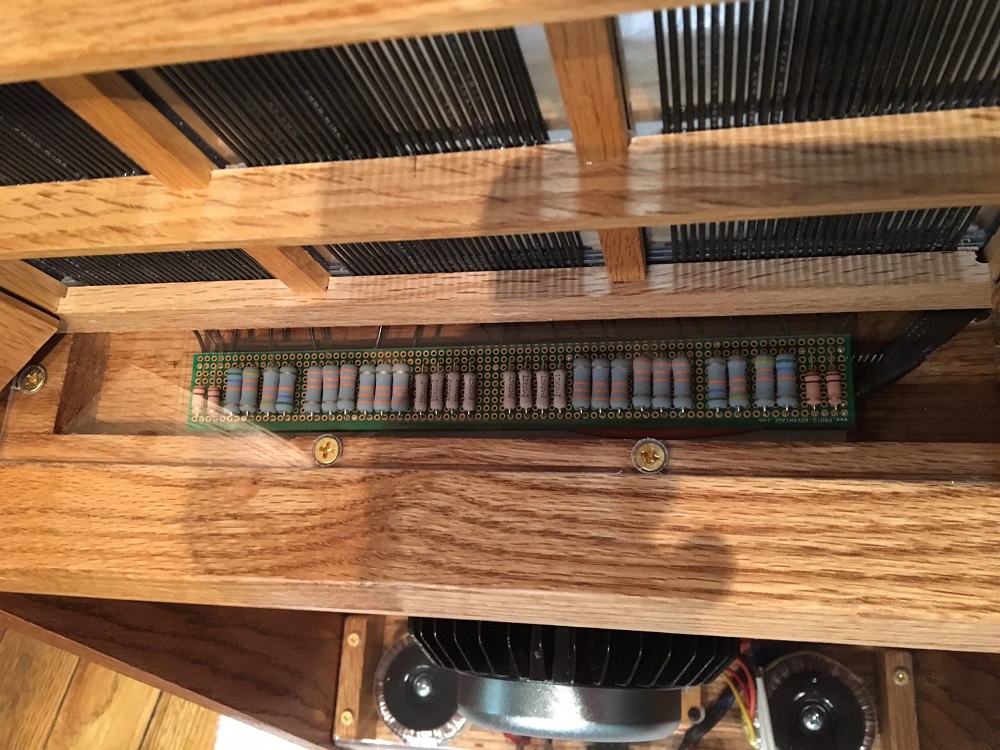

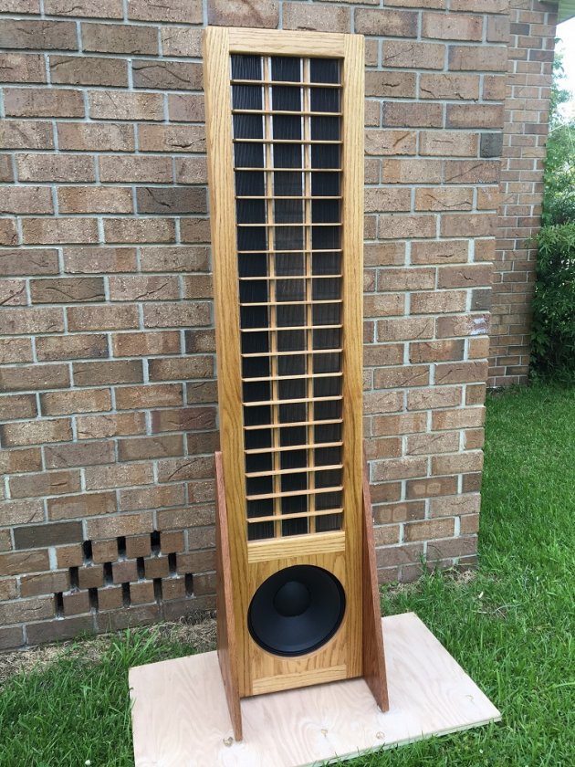

A phased array, wire-stator ESL mated to an H-baffle woofer:
Looks wonderful! Thanks for posting.

Jazzman53,
How many hours do you think you have into that pair?
