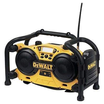

Try This    :thumb:

Thanks, we are looking for something a bit more sophisticated  :roll:
