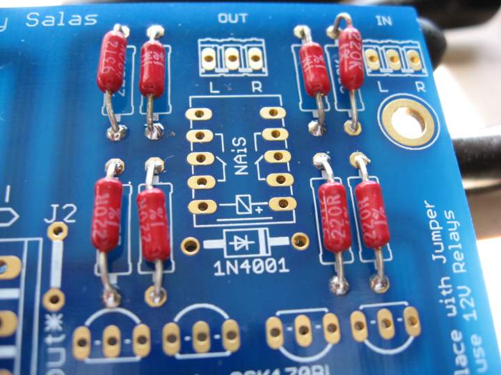

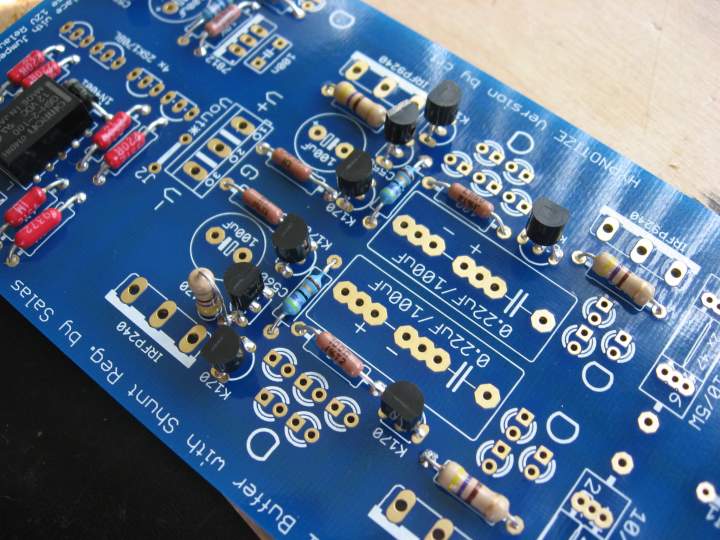

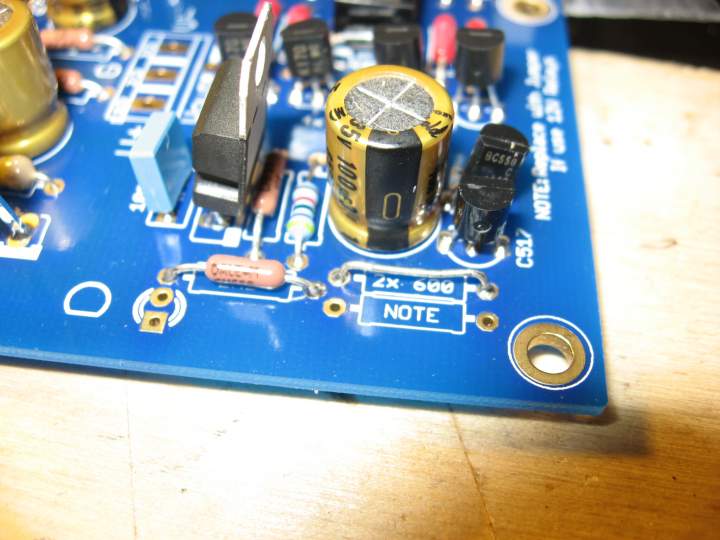

So you've got a whole lotta weird looking stuff in a box from Mouser, Digikey, Partsconnexion, etc. and this Baby Blue Board. So we'll just go one component type at a time, one packet a time, and put this thing together.
With the exception of the 4 matched jfets and matching LEDs, the build is straightforward. Values and part names are indicated on the board. However, as some of the components look alike (BC550s, 60s, 517, etc), double check before you solder. What I do is only open one component packet a time, add part to the board, then toss or put away the bag/packet.

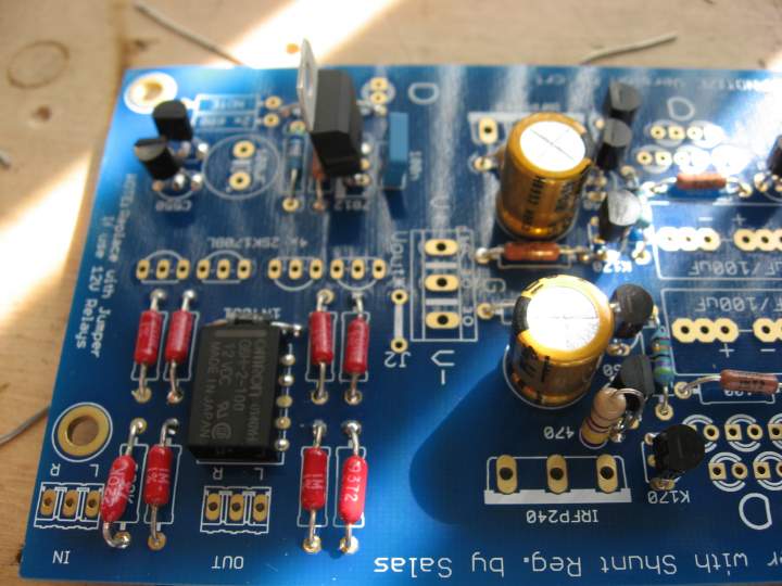

I like to start with the lowest height components first. Last thing you want to do is start with the capacitors and then find they're blocking/hampering your access to resistors and LEDs, etc.

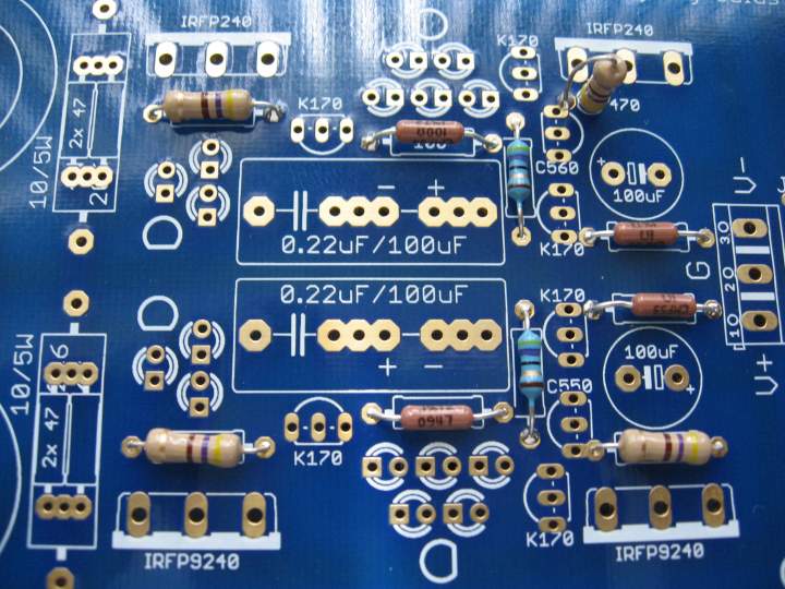

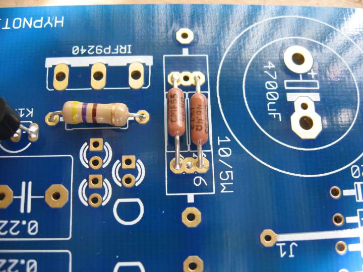

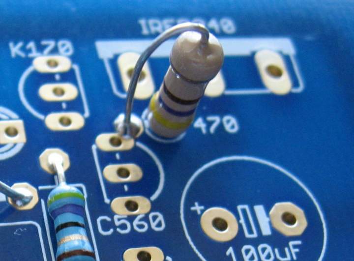

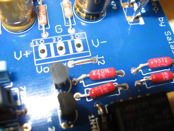

Resistors
The BOM linked above provides parts #s and tips for resistors. The new board is designed to accept larger sizes so you have a lot of flexibility.
Note the 470 ohm is vertically placed.
These 4 are critical for audio performance. If you're gonna splurge/upgrade, start here. The BOM
indicates which parts are more critical to sound quality, which is nice.
The values used here will be dependent on just how far you want to push your DCB1 aka HOT-ROD  :icon_twisted:. To be discussed later...
Schottky

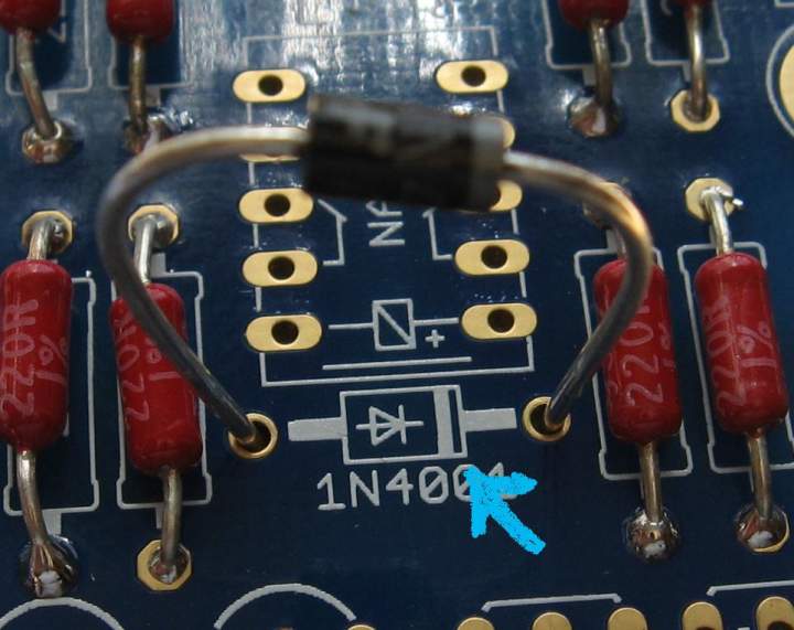

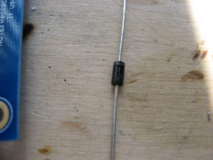

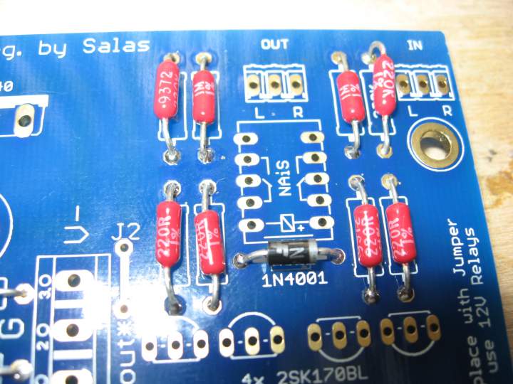

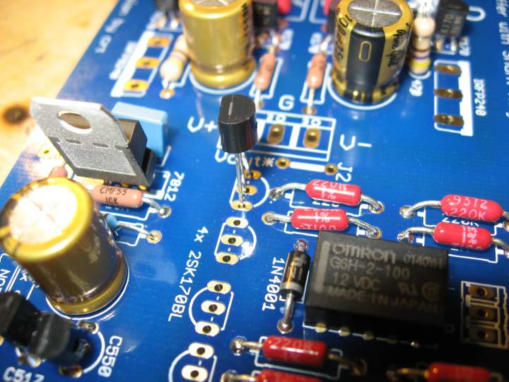

Since we're in the area, put in the IN4001 Schottky.
Note the white stripe one side.
Be sure that the orientation of the IN4001 matches the stripe on the board.

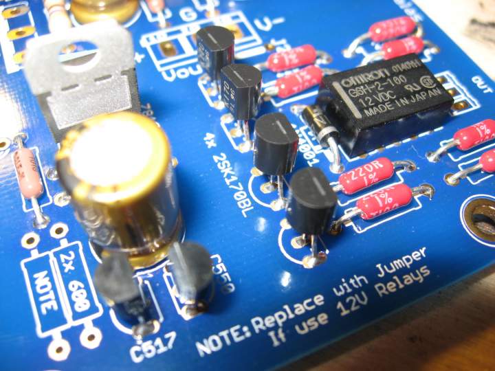

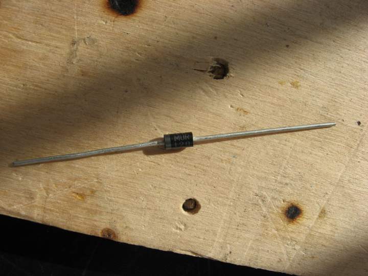

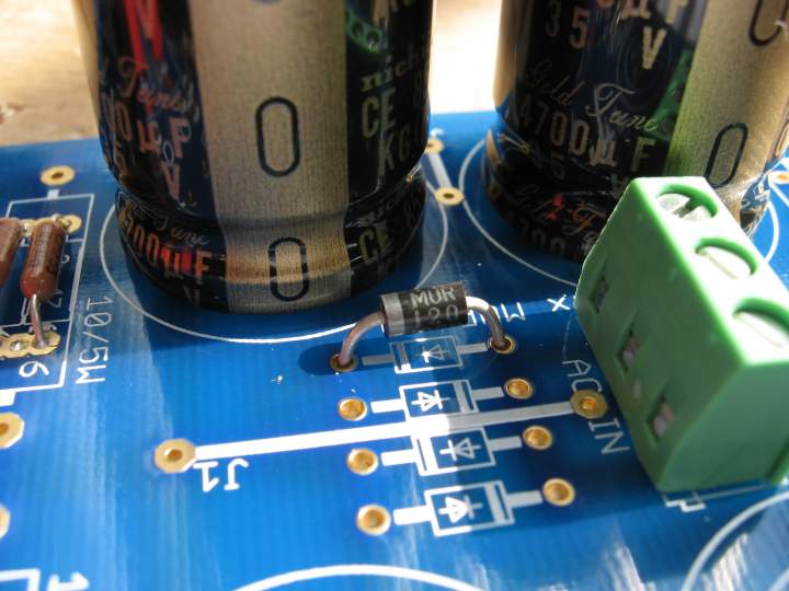

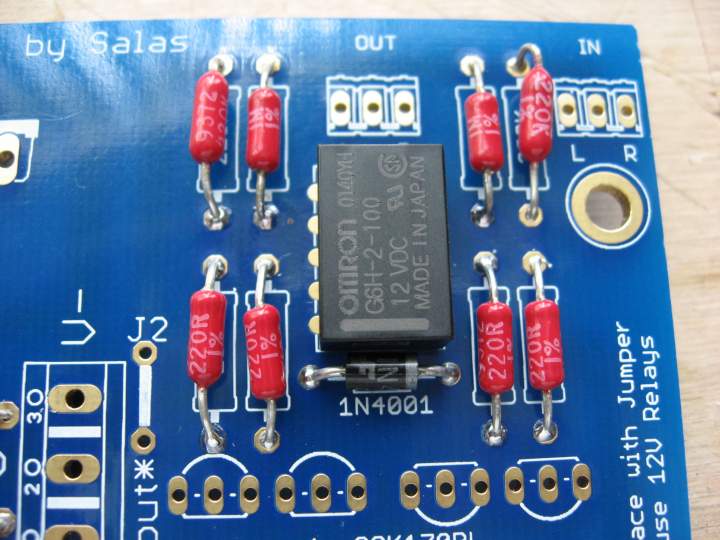

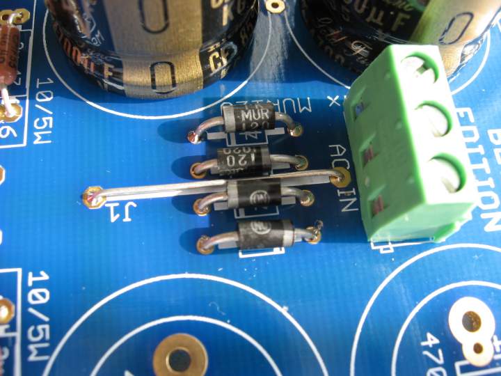

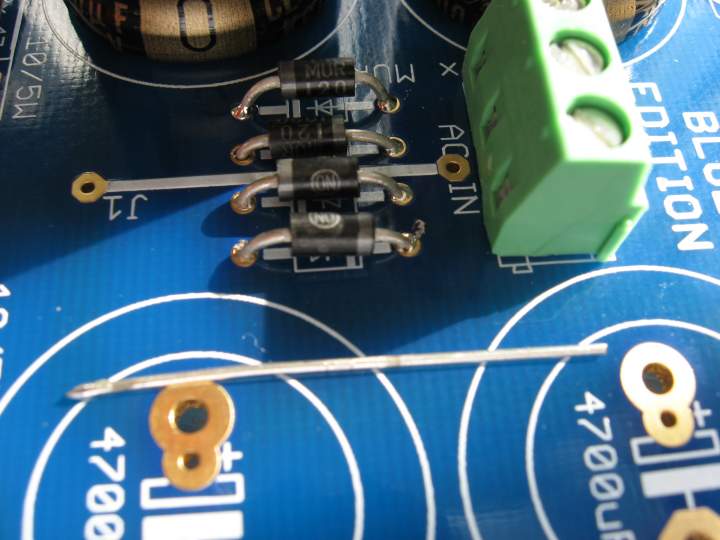

MUR120
Note the white line diving the MUR120s. This indicates a jumper is needed. Use some wire or a lead off a component.

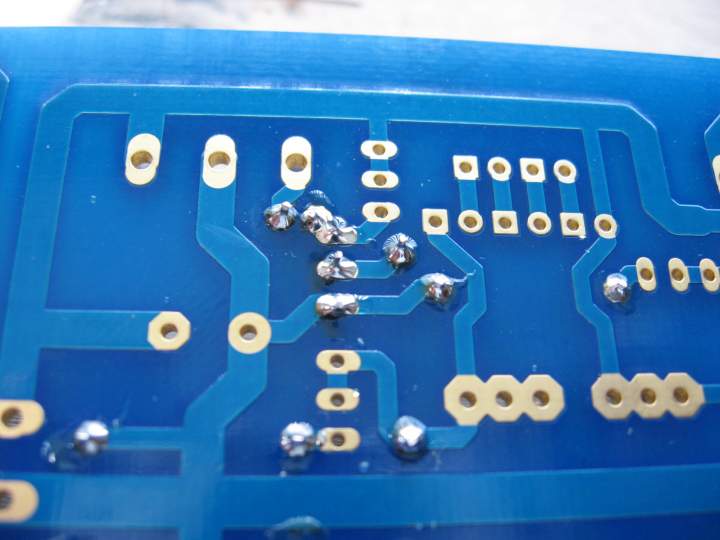

12VDC Relay
Plop the Relay in. Then take your iron with a little solder on the tip and solder one of the legs, while your other hand keeps it in place. This will keep it more or less in place and free up both hands agsin. Now properly solder another leg, then another. Be sure to push the Relay in occasionally as you do this until it is seated flush/properly. Repeat until done.

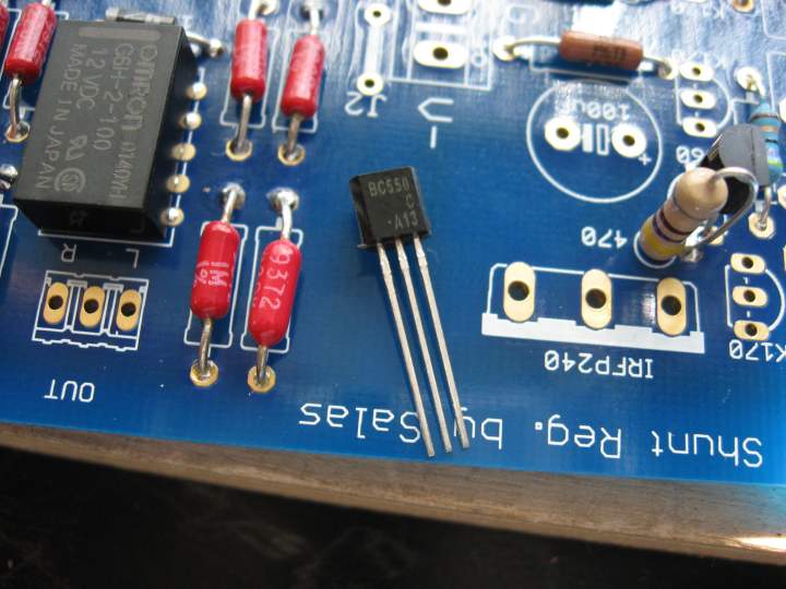

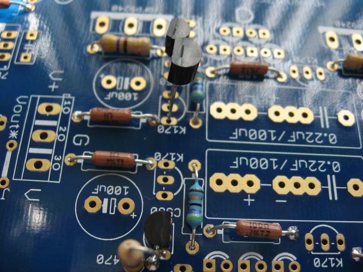

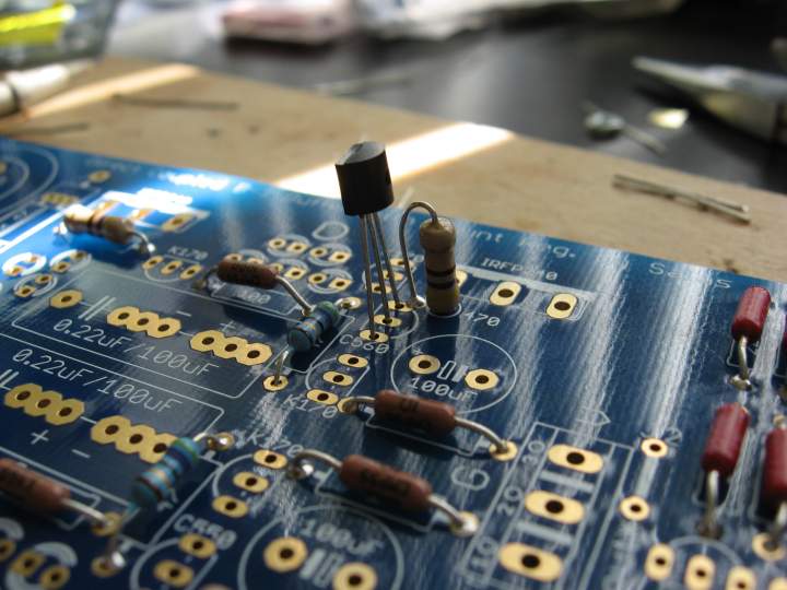

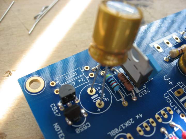

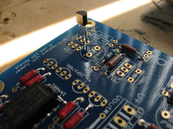

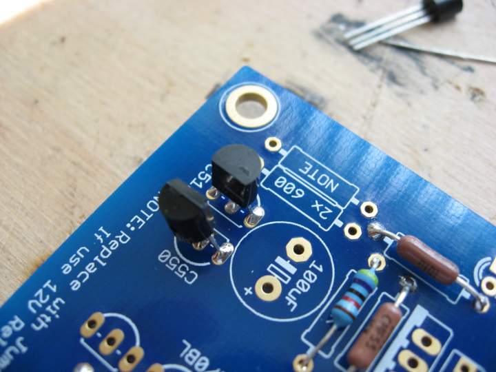

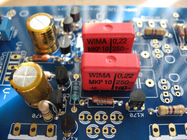

TRANSISTORS
There are a number of them used in this design, so once again, deal with one packet/value at a time.
BC560
Note the board shows you how to orient the fets. So be sure the flat of the back and rounded
front are facing the right way.

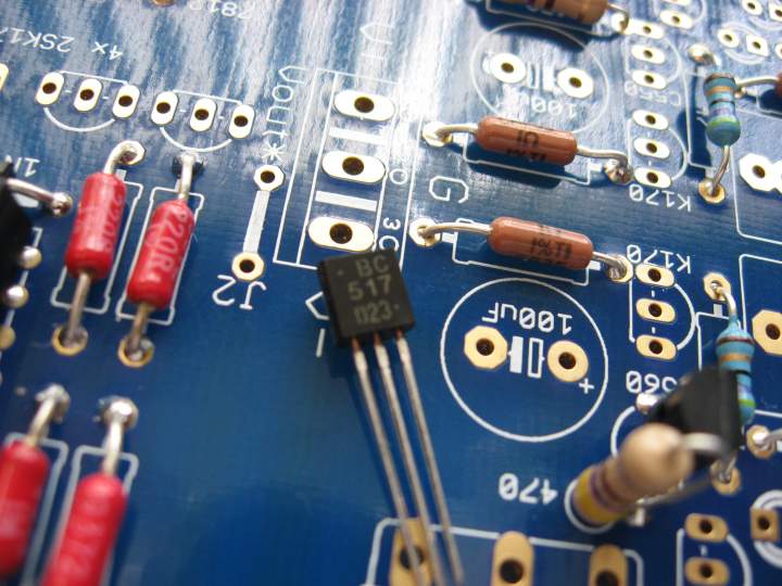

BC517
BC550
UNMATCHED 2SK170BLs
« Last Edit: 23 Aug 2010, 02:18 am by wushuliu »
wushuliu
  • Posts: 3766
Re: DC-Coupled B1 Buffer Build
« Reply #3 on: 22 Aug 2010, 02:15 am »

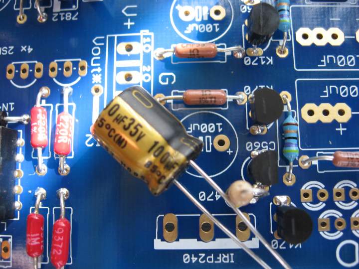

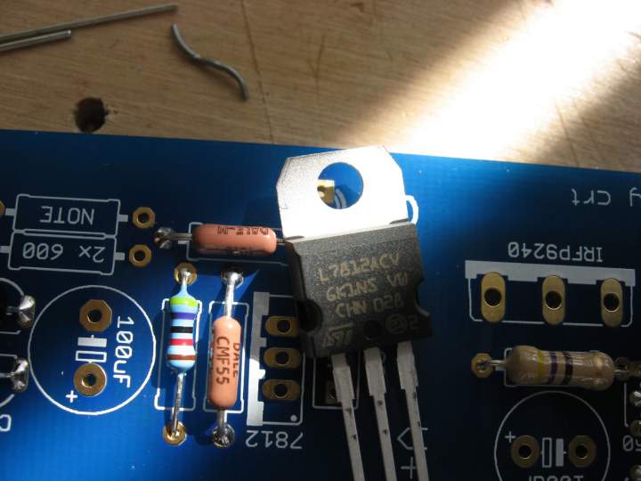

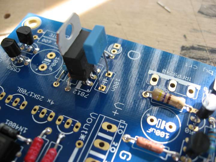

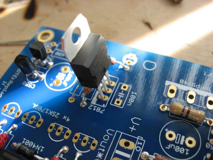

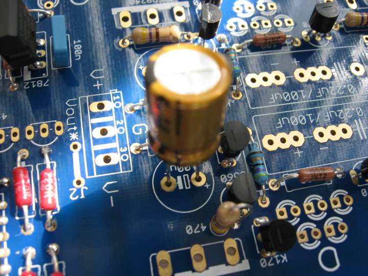

L7812

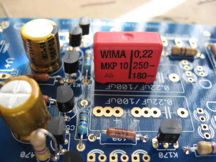

.1UF Bypass
100UF Caps
Make sure the polarity is correct. Striped side of a cap = Negative (-).
Film or Electrolytic for these.

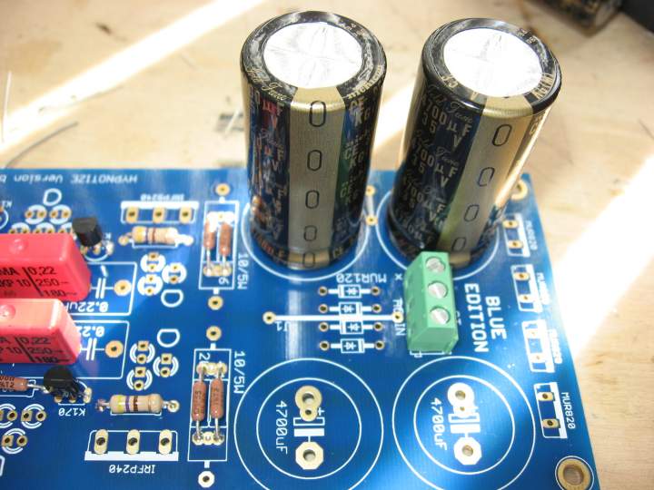

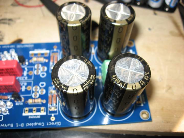

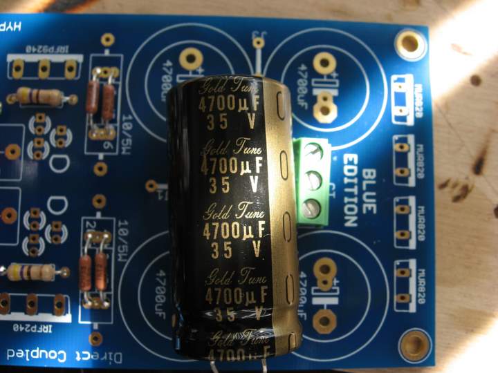

Power Supply Caps
The new board can accommodate larger sizes and values.
« Last Edit: 23 Aug 2010, 09:35 pm by wushuliu »

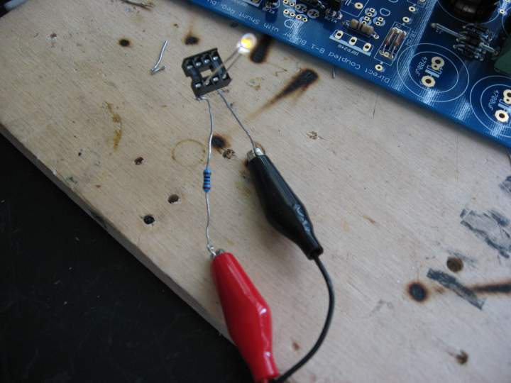

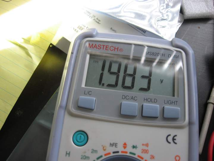

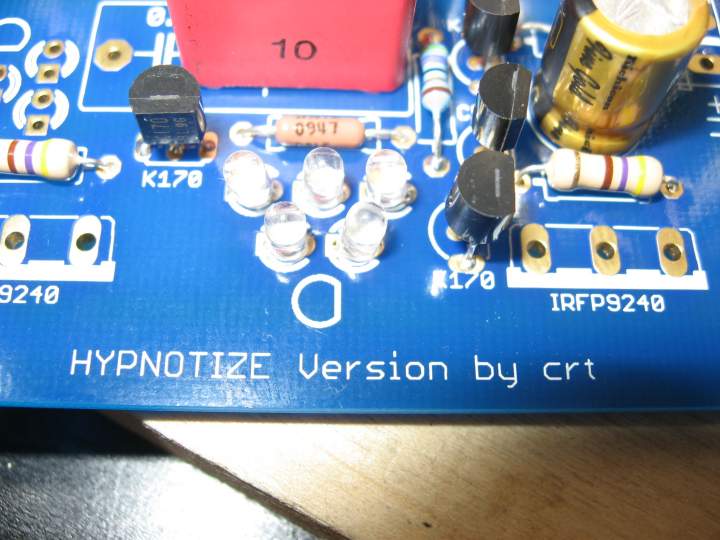

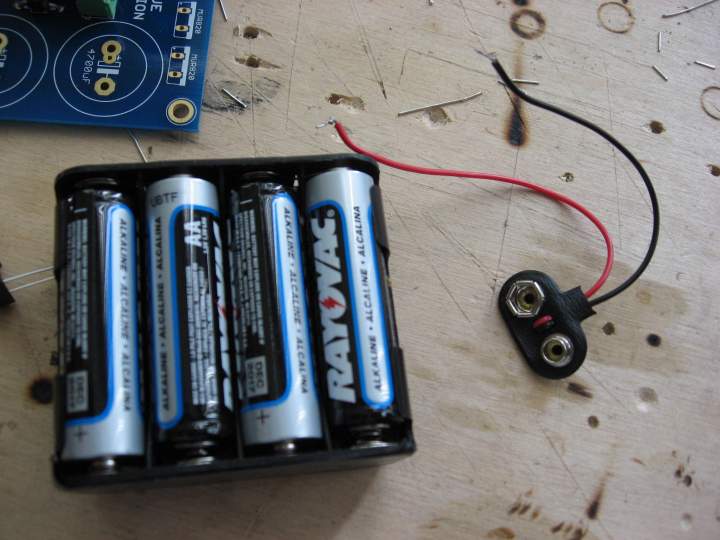

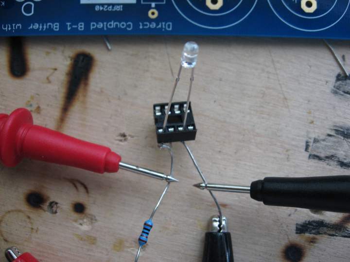

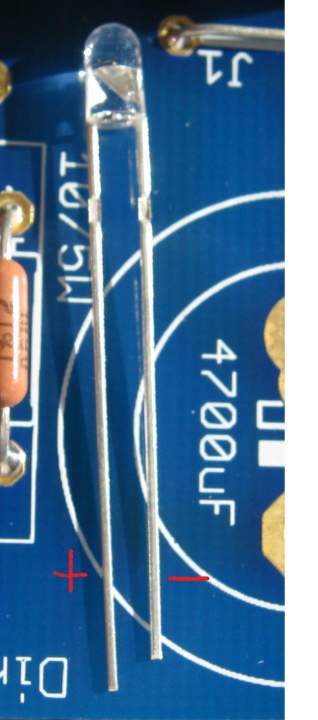

MATCHING LEDS
A number of LEDs are used in this design. The goal is to have the voltage from one side of the LED banks match the voltage on the other. Salas recommends using 1.8v LEDs, but you'll notice that the Mouser LEDs in the BOM are a bit higher - around 1.95v. This is acceptable. The main thing is that the total voltage from the LED strings are matched on either side of the board.
The Mouser LEDs are recommended because they are very closely matched, so no need to go order and sift through a 100 LEDs to match the voltages.
However, it's still a good idea to at least test some of the LEDs from Mouser just to be sure the specs are still tightly matched. So here's an easy way to do that.
This is also useful if you have some on hand or would rather run to Radio Shack or another vendor.
You'll need your DMM, 1k ohm resistor and a 9v or 12v battery. I happen to have a AA 12v battery holder, so I used that.
Although not necessary, something to hold the LEDs while checking is useful - in this case I used a cheap dip socket from Radio Shack.
LED
Long Lead = Anode (+). Short Lead/Flat Back = Cathode (-)
Connect one side of the 1kohm Resistor to the Battery (+), the other to the LED (+)
Connect the Battery (-) to the LED (-)
Place your DMM (+) on the (+) resistor and the DMM (-) on LED (-), and record the voltage (DC)
As I said, the Mouser LEDs have been closely matched. To be thorough you should order a few extra and test them all, just in case.
Now start plopping them in. The board has an LED symbol with a flat back/cathode to indicate which direction you're LEDs should be facing.

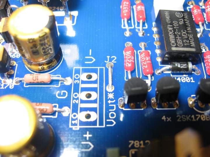

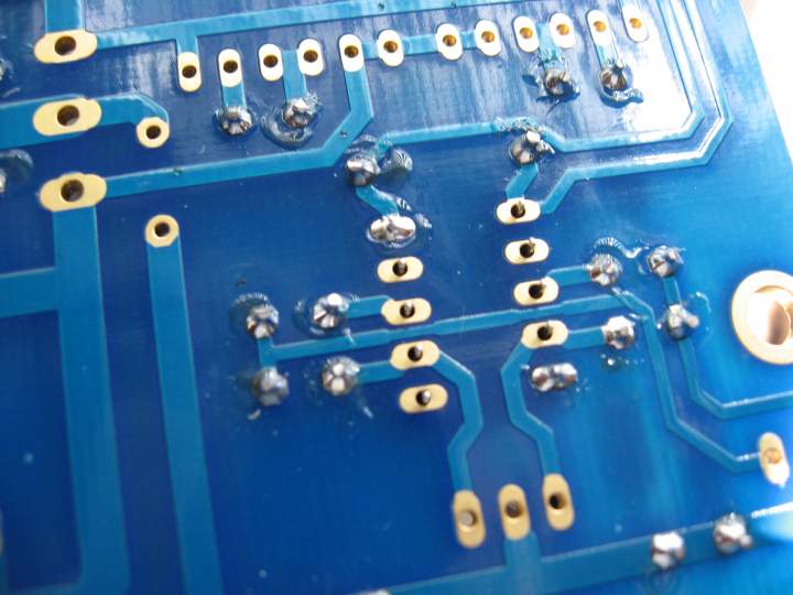

JUMPERS

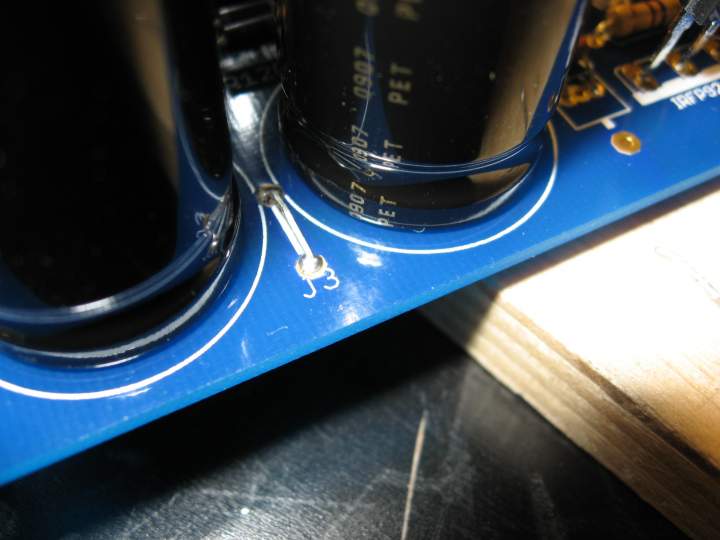

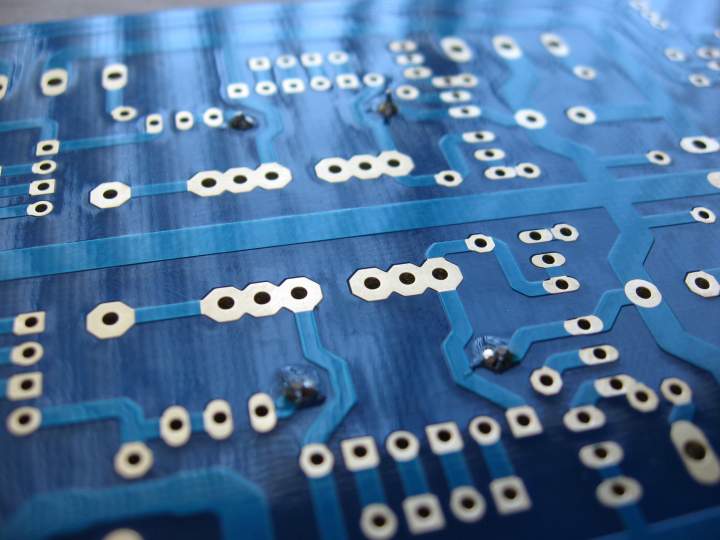

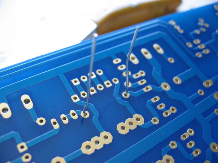

Several areas on the board are marked for jumpers - just a piece of wire or whatever you have handy.
This one is to be used if you bought a 12v relay.
J2
J3

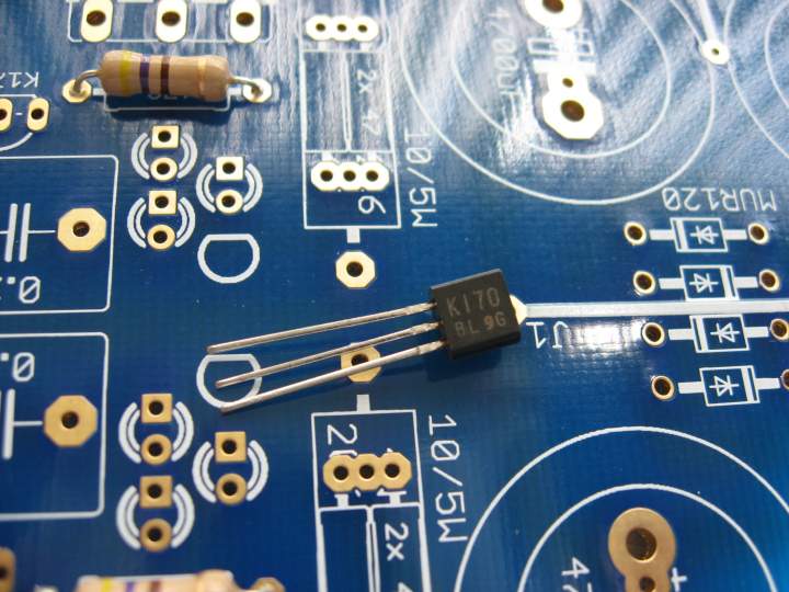

MATCHED SK170BLS

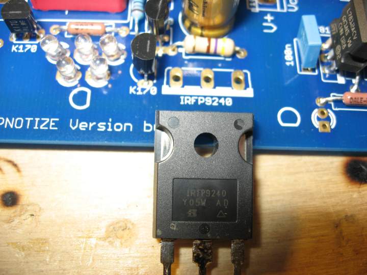

Next up, the 4 BLs w/ matching Idss. Again, note the orientation as provided by the board

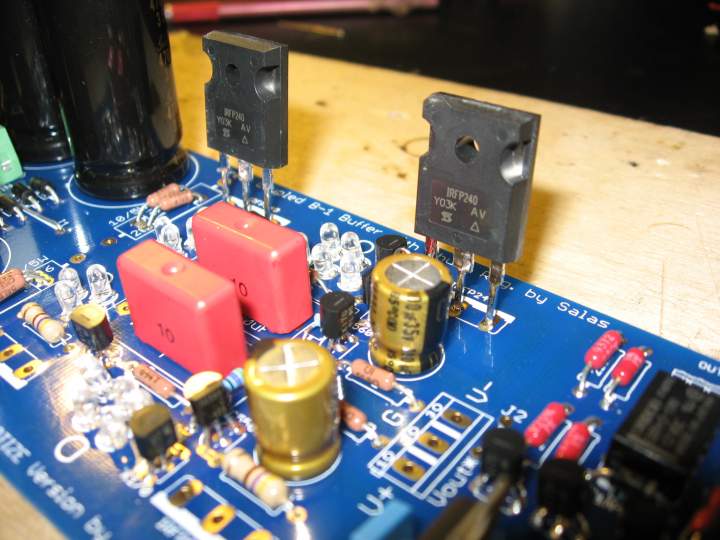

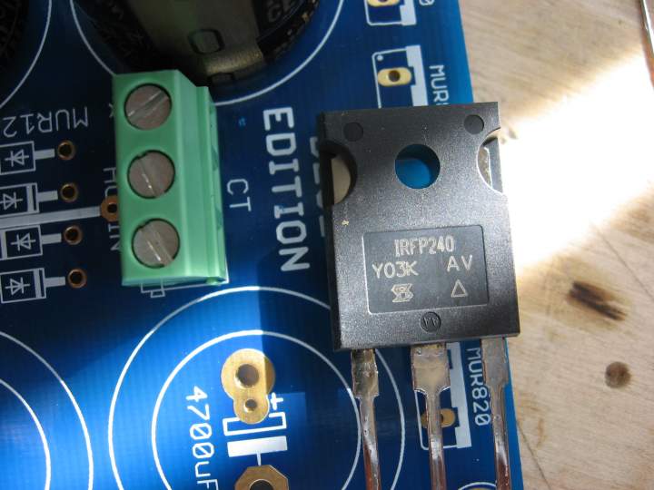

IRFP240
Be sure to not mix up the IRFP240 and IRFP9240s, since they looks so similar.
Vertical/horizontal placement is up to you depending on if you intend to use heatsinks, sink to the chassis, etc.
IRFP9240

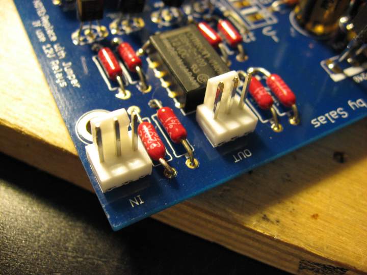

INPUT/OUTPUT MOLEX

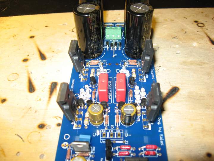

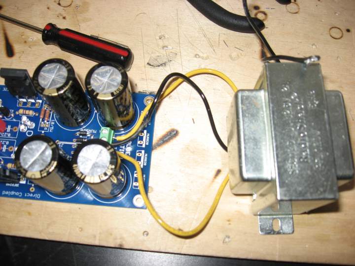

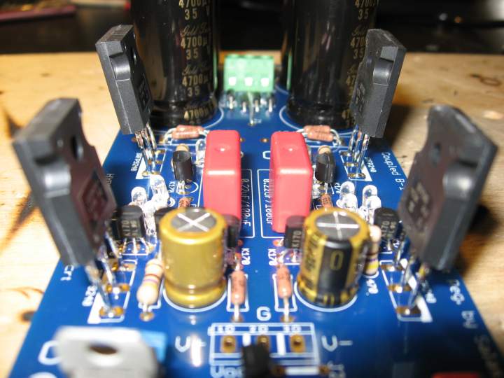

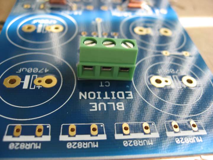

OK, the board's all populated now you need to fire her up!
TRANSFORMER
Here is a cheap 25vct Radio Shack transformer. I have used 2 of them and they work great, no problems but some have reported buzzing issues in the past.
Note the center tap (CT) goes to the middle. If you have a transformer with secondaries, please refer to the manufacturer instructions for wiring the CT.
Since everyone's wiring needs/preferences are different I won't go into the AC/Fuse/RCA/Potentiometer stuff. You're on your own there.
CHECKING THE VOLTAGE
Once you have your transformer and AC all set up, turn on the board. ALL LEDS SHOULD LIGHT UP!
Now, grab your Digital multimeter and check the +/- Voltage. Set your DMM to DC Volts. Place one probe to V+, the other to G. Note the voltage. Should be over 10v. Now check (V-) and G. Should be similar amount. Doesn't have to be exact. If there is a gross difference, you'll need to trouble shoot.
« Last Edit: 13 Sep 2010, 05:22 am by wushuliu »

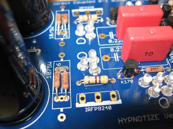

HOT ROD
Hot Rodding a DCB1 increases the current going to the board. The stock current is around 60mA(?) w/ 34ohms (those parallel 68Rs on each side). But the more current you feed the mosfets, the better the sound quality as a general rule. Salas indicates this occurs in tiers, ~200mA being the next tier, 600mA after that, and then around 2A(!). But there's a catch: Heat. The more current, the hotter those mosfets get. Stock values you can forego heatsinks, but beyond that you'll need them. I'm pushing 600mA on my DCB1, using the entire 12x12 enclosure of my integrated amp as a heatsink with the mosfets bolted to the chassis AND a fan installed. :o :flame:
Is it worth increasing the current. Yes. Definitely the 200mA tier at least. Soundstage, three-dimensionality increases.
How do you increase the current? Resistors. The resistors by the PS caps. The BOM lists parallel 68R (=34ohms) as basic value (though the board shows 47R, which is fine as well), and 10ohm 5W for hot-rodding. You do not use 2 10R per side, just 1. This a guideline, you can increase or decrease values as you deem fit.
If you do Hot-rod, it is recommended to get a slightly larger transformer, preferably a 15v w/ 50-100VA. Also the BOM lists the MUR820 diodes instead of the 120s for hot-rodding. Note their placement by the PS in the pics above.

This is exactly what I do. I seem to have an 'eye' for how much I should bend so it falls in perfectly flat & flush with the board. Just remember that in areas of higher current where the resistor dissipation is more than say 1 watt, you should have the the resistor standing a little bit for better heat dissipation. Probably not really an issue with this build, and more with tube amp builds, etc...
 :o For the LED's the voltages should match on both sides of the bank, not necessarily be 5.4V DC (for 3 LED's each being 1.8V) or 9V DC (for 5 LED's).  Got it, thanks. :o
Anand.
I'll second the mouser recommendation for LED's. All the ones I have measured thus far (34 of them!) have been very close to 1.936V or thereabouts. Some are 1.934V but most are within 1.934V to 1.937V, which is super tight matching!
Anand.

I've started to populate my board with the resistors I have on hand. A couple questions...
What is the Hot Rod version you referred to earlier in the thread? I suspect the answer to this question may shed some light on why I have two 47R resistors when it appears the board requires four.
Also, as stated in the BOM I ordered four 68R resistors but I can't find a home for them on the board.
wushuliu
  • Posts: 3766
« Reply #17 on: 13 Sep 2010, 11:56 pm »
Not sure why there is a discrepancy b/w the BOM and the board w/ these values. But neither value are considered considered hot-rod. Use the 68R resistors.
toxteth ogrady
« Reply #18 on: 14 Sep 2010, 12:36 am »
Wushuliu,
Just so it's clear as to which resistors I'm referring to, see the last photo of your 4th reply in this thread; It's the four brown resistors located next to the 4700uf caps. The board is marked 47R x 2 but you're suggesting to use the 68R in their place? Thanks.
wushuliu
  • Posts: 3766
« Reply #19 on: 14 Sep 2010, 12:45 am »
Wushuliu,
Yes
