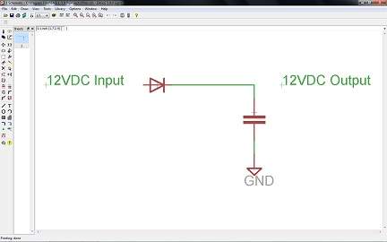

Did you put the diode in parallel with the DC input as Gary does for protection, or in series with the DC input?  In parallel, it will only limit voltage peaks to the diode Peak Inverse Voltage rating.  In series it will also protect the unit from reverse voltage, will have a max 0.7VDC drop across the diode and may help with back noise transfer.  If you follow the diode with a capacitor to ground, it will also help with HF noise getting back to the other wiring.

This is what I am describing.
The diode still needs a high current rating like the one that Gary uses.  The voltage drop across the diode will be up to 0.7VDC depending on current draw.  The cap should be a plastic film or HF cap like Silver Mica to help filter any noise at high frequencies.

Hmmm, would that 0.7 VDC drop be bad for any components running off this power source?  What size cap should I be looking for?
How much do I loose out if I don't have this in place?

The cap does not have to be a large value, probably 0.1uF/50VDC to act as a HF filter for any noise the components downstream might generate.  Just has to be a cap that works in the frequency the component generates noise.  That is why a silver mica or film cap would be a good option.
If it already sounds good without it, I would not bother.

If so, try the parallel caps on the Neutrik output connector without changing the diode and see if it makes an improvement.  By putting it at the output Neutrik connectors will help shunt the noise to ground before getting to other components.
