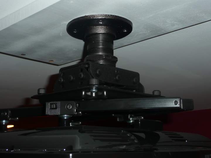

A picture of it hung
Mount using a metal flange, nipple and bushing into a Chief RPAU.

Looks good  :thumb:.  I can't get mine to die so I can upgrade it.  I like that they put the lens in the middle so you don't have to account for the offset.
Yes, it's critical given the lack of a horizontal lense shift.

I think whether you have to account for the offset depends on what your previous projector was.  For instance, my projector has its lens on one side of the projector, which means that a new projector with the lens in the middle will present a problem.  However, I purchased a mount that allows up to three inches of horizontal shift.  So, when I finally get around to mounting my projector, I'll ensure that I can also mount a projector with the lens in the middle.  The only problem will be if I were to consider a projector with a lens on the complete opposite side from where my current projector's lens is.  That would be a problem.  In that case, I'd have to move the mount.

Yes, I understand.  You're right.  In my case the mount and lense are centered, so horizontal alignment was easy once I installed the pipe to allow swivel.

Thought I'd highlight that the Chief RPAU mount doesn't fit the LG mounting connection points in a correct manner, but it still works.
The LG connections are too close together for the Chief to use a classic X pattern, where the legs radiate out.
Rather I was forced to orient the legs to make two A patterns, >>.  This allowed me to connect the LG to the Chief using the provided baseplate.  It works fine, but the plate is shifted back a few inches versus being direclty over the center of the LG.
I had a concern that this would introduce an eccentric load to the mount.  But it's fine after you make your lense adjustments.
If you have a Chief RPAU and are looking at the LG, it'll work.
If you're looking at the LG and also need to buy a mount, I'd probably not recommend the Chief.
