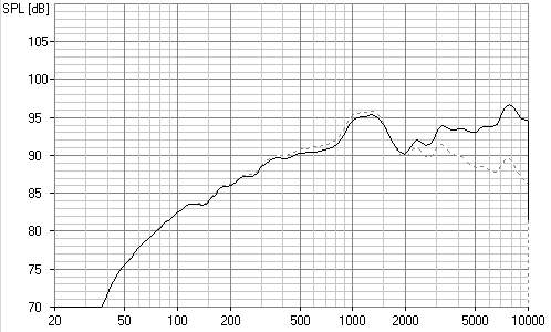

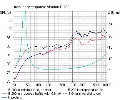

the Boxsim simulation of the B 200 in your new baffle reveals a lot:
Black is the B 200 in infinite baffle. Official efficiency values are taken from that diagram at 1 kHz. You see how 94 dB are just reached at 1kHz. At 700 hz it is only 90 dB :(
Blue is the response in your narrow baffle. The dipole peak around 1 kHz emphasizes the already visible 1.4 kHz hump of the B200.
Red is the influence of the 0.6 mH inductor. Dashed red includes an added parallel 6 Ohm resisitor.
A more detailed simulation shows the response at 90 dB at 500 Hz and again at 2 kHz. In between is a hump of 5 dB:
Dashed line is the 6 Ohm resistor again.
I don't know if the hump exists in reality too, but it could be fixed with a notch filter.
The above would explain, why the B200 fits quite well with the Neo 3 efficiency.
