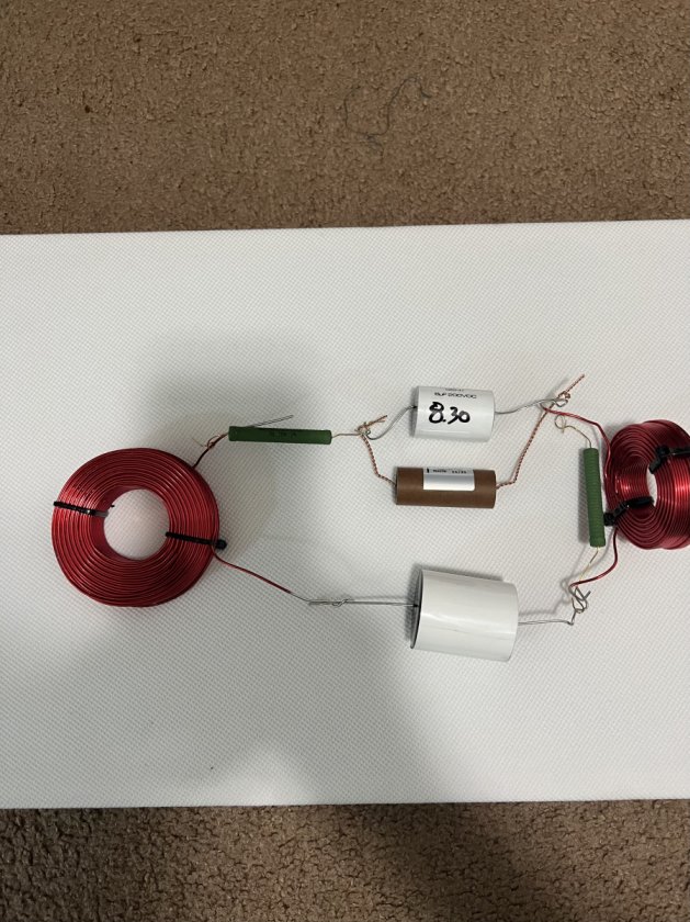

Greetings,
Working on a pair of NX-Studios. Could you please confirm my crossover is correct?
Thanks in advance
Looks good. Just make sure to have the inductors orientation at a 90°.

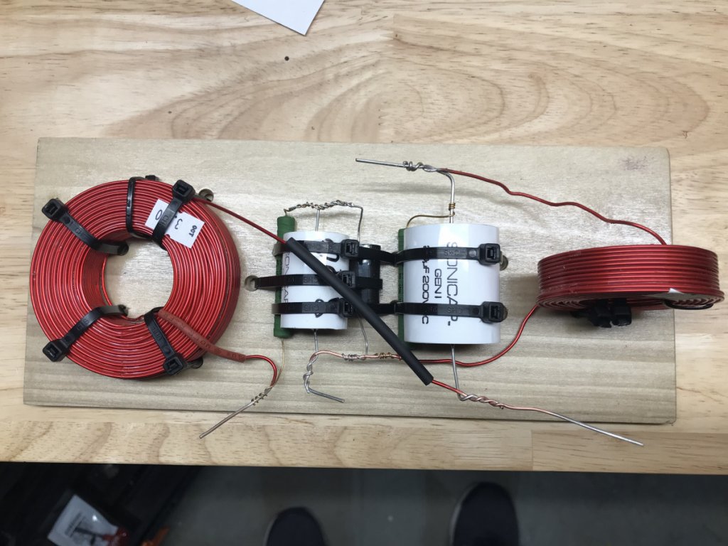

« Reply #341 on: 14 Nov 2022, 08:40 am »
I hope I’m not gonna make an idiot out of myself, but you mean like this?

« Reply #342 on: 14 Nov 2022, 01:18 pm »
You were good to turn it up on its side but rotate the small inductor 90° so it is perpendicular to the large inductor. That will cause the least interference between the two.

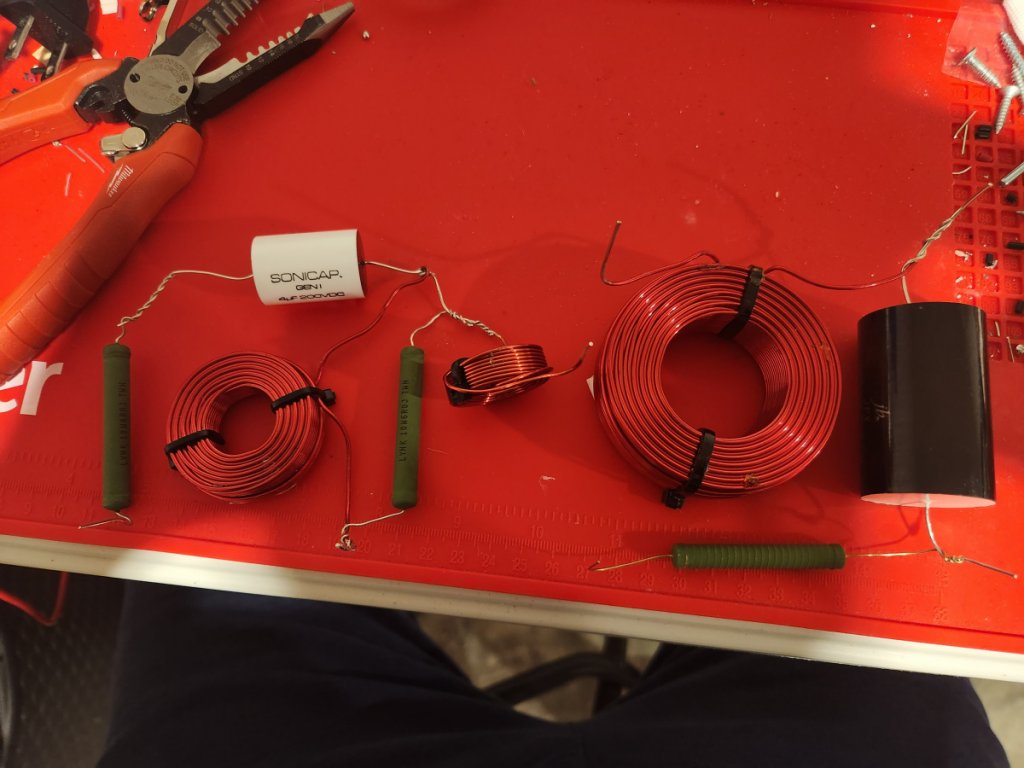

Good evening,
I am just verifying that the crossover looks correct before I solder, the crossover is for an NX Studio.
Thank you, Kelly

Here is my layout for the RP-600M II upgrade so far, tweeter on left, woofer on right.
Waiting for the paint to dry on the MDF boards so I can attach with zip ties. I followed Danny's guidelines for part layout and drilling holes for mounting and for zip ties.
