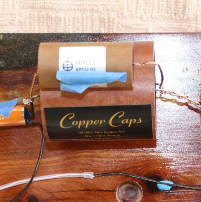

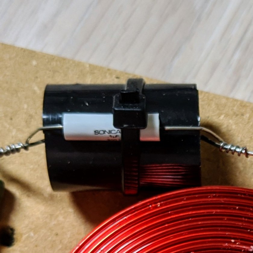

Heres the one on my base XLS:
And the one on mikeeastman's NX Studio:
Both do the same thing but are totally different quality levels.

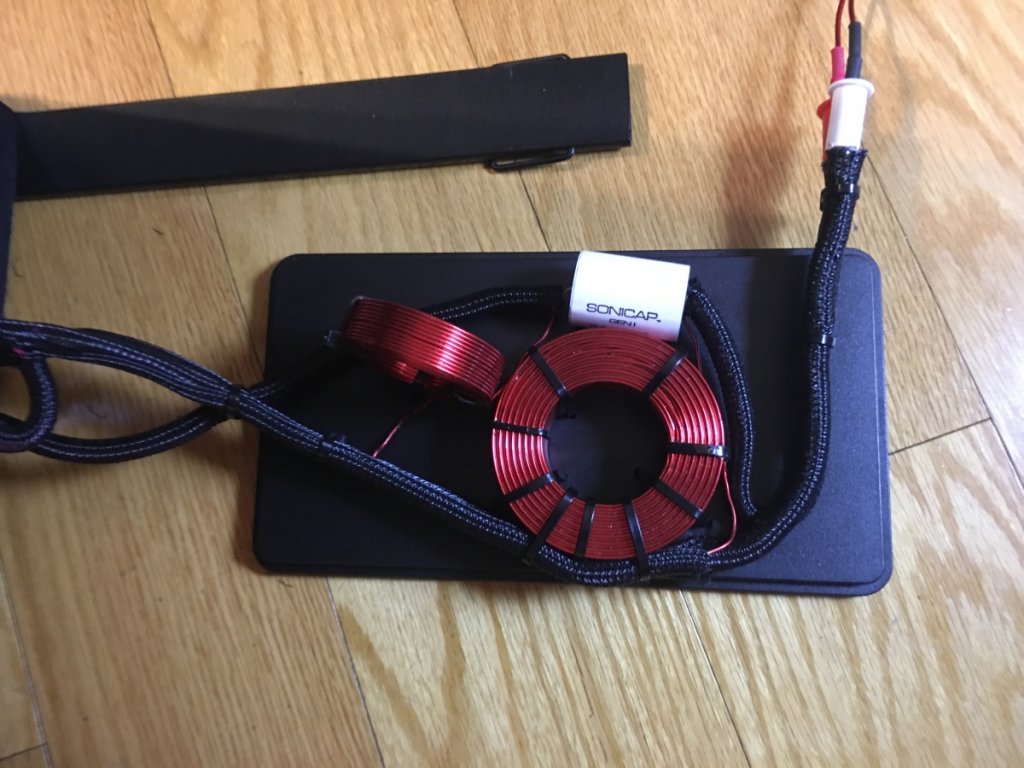

Danny the crossover wizard...
...opened up my Magnepan MMG's by providing me the crossover parts to build myself.
They are on another level, with the addition of Rythmik 12" sealed Servo sub.
Hobbsmeerkat
  • Posts: 2741
Re: Crossover assembly 101
« Reply #257 on: 14 Dec 2020, 04:28 pm »
Love the cable sleeving! Really tidies up the looks!
Tommy
  • Posts: 6
    • Tommy Lentsch
« Reply #258 on: 15 Dec 2020, 02:39 pm »
Thank you!
I love Techflex Flexo F6!
For this I used 1/4"
