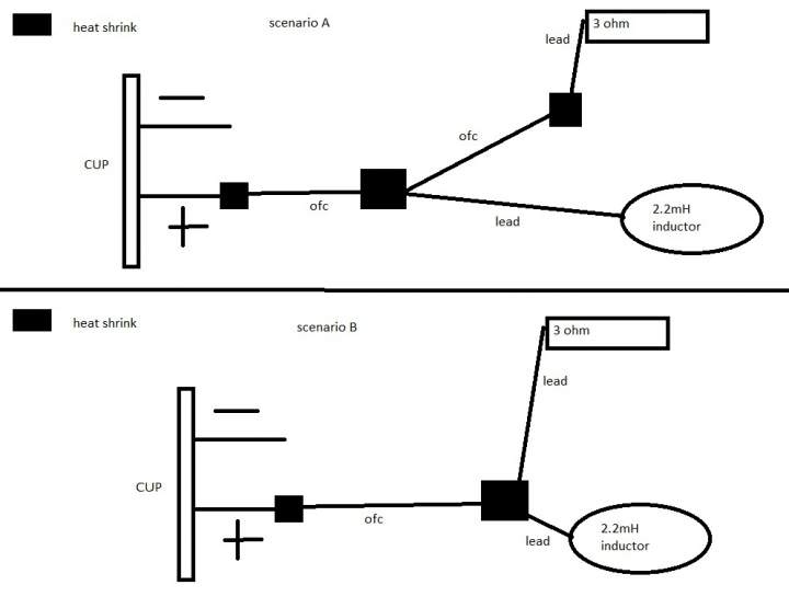

I assembled my first A/V-1 crossover using scenario A, because I assumed it is "bad" to attach the leads of the resistor and the inductor before connecting to the OFC wire (scenario B).  The diagram from Danny shows separate wires meeting at the post on the cup.  For cleanliness, can you just use one wire like I did in scenario A, or is it necessary to use 2 separate wires (one from the inductor and one from the resistor)?  Thanks for your help!
Danny Richie
Re: Crossover assembly 101
« Reply #91 on: 7 May 2012, 01:24 am »
The way I wire it is like scenario B, but it can be done either way.

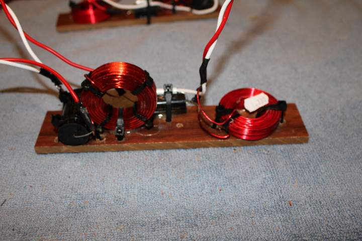

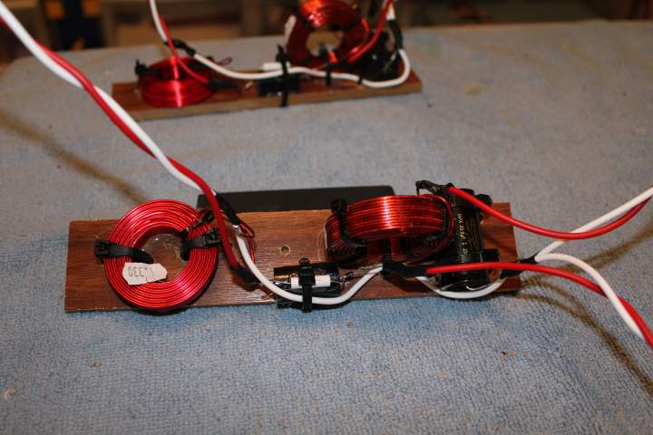

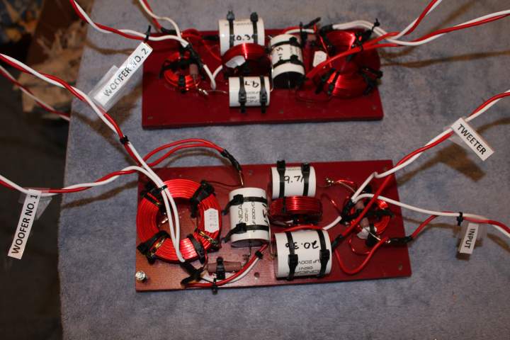

  A fellow Audio Circle member recently asked me to construct single board crossovers for a pair of N3 TL towers that he is building in lieu of separate low and high pass filter boards. The boards were cut from scrap pieces of 1/4" thick Pergo flooring that Ihad in my shop and are 4-1/2" wide x 9-3/4"long. The parts are secured to the board with hot glue and plastic wire ties. Also, each board is secured to the interior cabinet walls with six(6) No. 8 x 1" long Hex Head sheet metal screws and 1/4" thick vinyl bumpers between the board and the cabinet wall. The following picture shows how it looks:

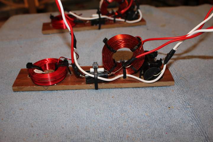

  Attached are pictures of the crossovers I just completed for a pair of GR Research A/V-1RS surround
speakers. The boards were constructed from scrap pieces of Pergo laminated flooring and were cut to 9" long x 2" wide x 1/4" thick. Parts are secured to the boards with hot melt glue and plastic wire ties.
