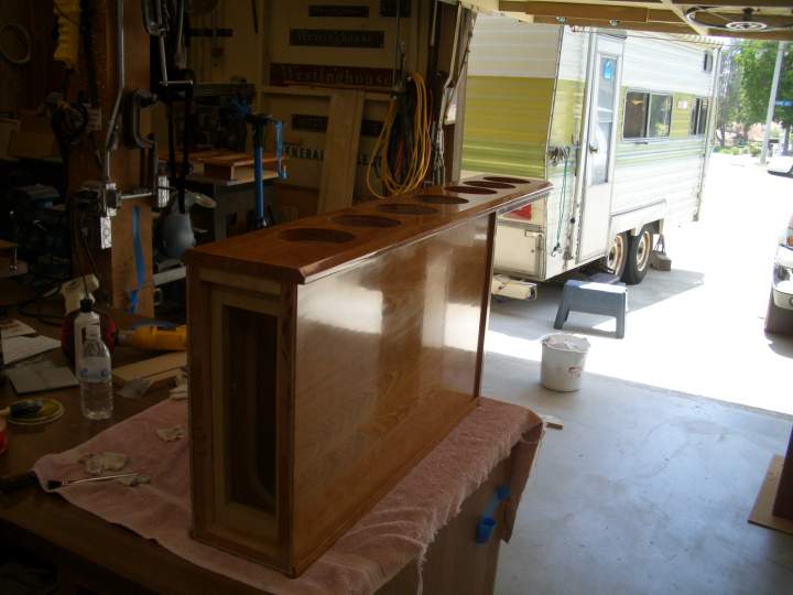

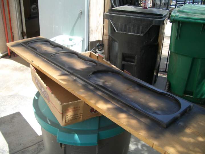

More build pics.

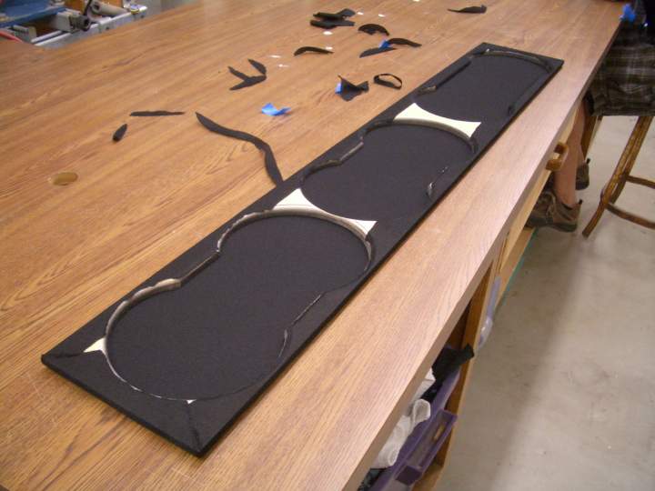

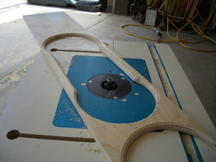

Making the grills, used 1/2 Baltic Birch ply.

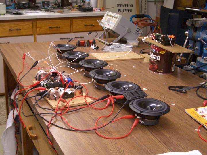

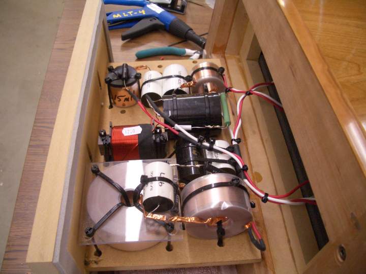

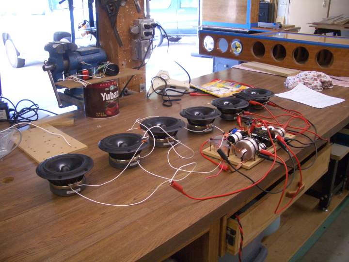

Crossover smoke testing

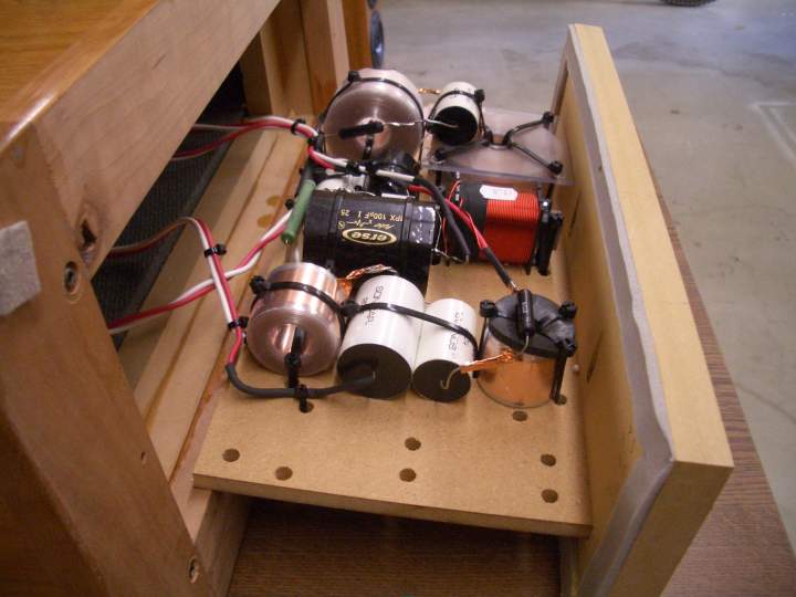

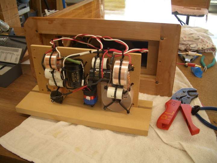

More crossover pics.

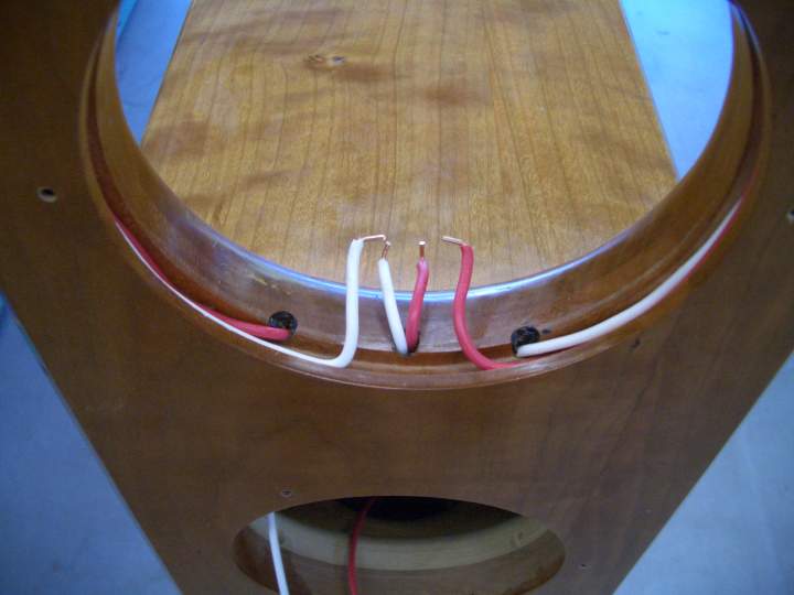

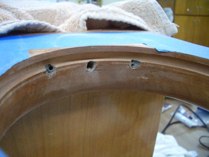

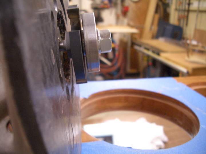

Slot cutting to recess wires

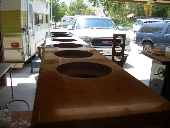

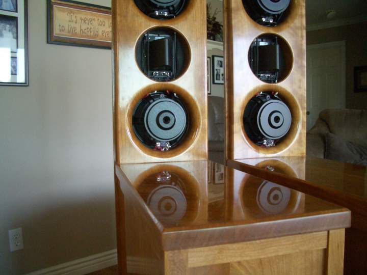

I used wipe on poly from General Finishes, lost track of how many coats.
Definitely the hardest and most frustrating part of the project.

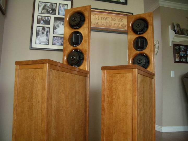

The final product

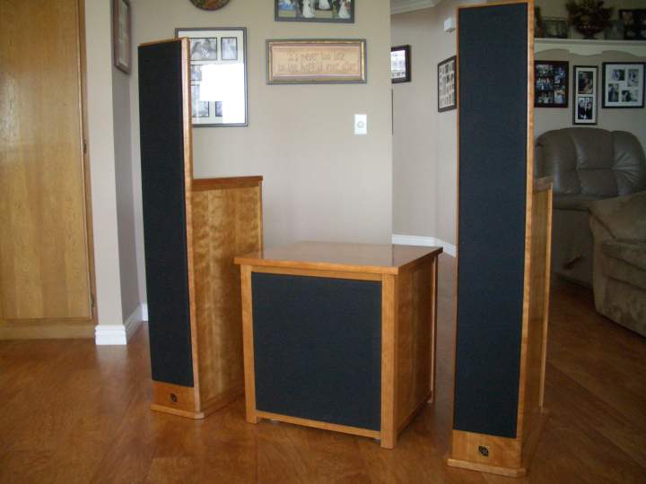

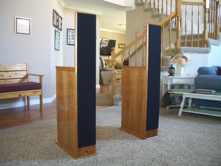

With grills
With matching servo sub.
After 3 weeks of listening, I am still blown away by how good these sound.

Those speakers look great.  I really like the way you hid the wires.

"WOW" thanks for all the compliments, these speakers are amazing. The N2X demos gave me the push to go ahead and pull the OB7 trigger. The OB are exceeding by leaps and bounds, all my expectations.  During the build, I wondered about the return on my investment of time, sweet and blood, ( I actually put a nice slice in my finger from a very sharp up cut spiral bit ). Anyway, long story short, I am very happy. I have been knocking the dust off of my old CD's, and can not believe what I am hearing. The speakers just disappear, and sound seems to come from behind them. Hearing the details of all the individual instruments is fun. Half the time I do not even run the sub, early mornings while the family is sleeping. They even come alive at very low volumes, with my old speakers, I always was cranking them up, to try and get some kind of life out of them. With the OB's, it is just the opposite.
Is that a 15" Servo??
They blend very well with the 15" Rythmik servo.
I am able to cross it over in the low 50's, and the slam feels like it is coming from the OB's. The M130X upgrade was worth it, they really cover the mid bass, tight and controlled.
That was an after thought, at first I just tried to tuck them in around the speaker, Danny said that was not a good idea soundwise. So I bought the 1/4 by 1/4 inch slot cutter.

Seriously, though, that is some amazing woodworking skills! I REALLY love how the wires are all hidden. It looks better than most professionally built speakers. Absolutely stunning work and I'm sure they sound even better than they look  :thumb:
Scott
EDIT: I wanted to add, those are the best looking grills I have ever seen. They are absolutely svelt and don't look like an afterthought. I actually like the speakers better with the grills on; not because your woodworking doesn't look good, but because those grills look THAT good! Nicely done ...

Thanks a bunch Scott,
I really liked jdbrian's OB7's build with grills, and I figured that I would probably never go back and do it after they were up and running.
They are a huge component of the WAF.
