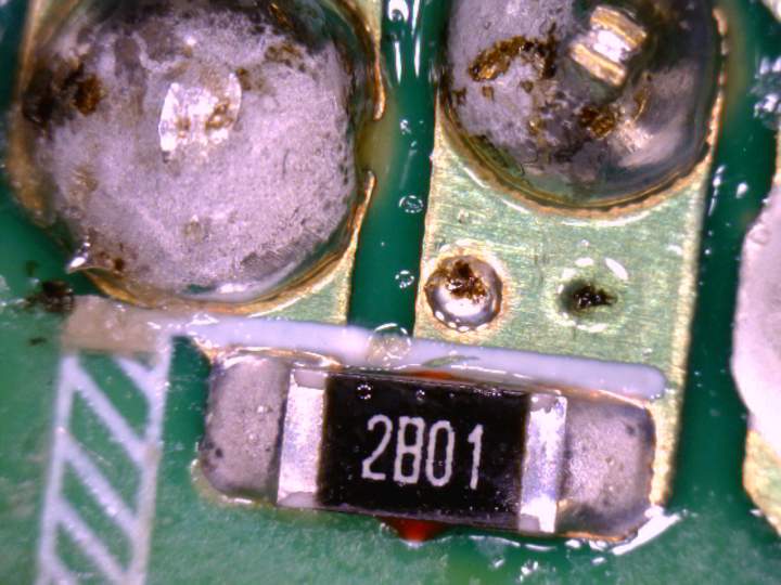

I just now snapped apart my Mac Mini supply.  The sense resistor on this supply (late 09 model, I believe) is 2801, or 2K8.  I suspect the value of this resistor isn't critical.  It probably needs but to generate a small voltage across it, so a range of 2-6K probably works.  But j'speculate.  Maybe these things are built to exacting specifications (say it isn't so).

The thing I like about surface mount technology is how easy it makes removing components for replacement or use elsewhere.
Into the Hynes supply it goeth.

Ok, the iMove sense resistor now has a new home in my iHynes Mini Power Supply, iSupply for short, which is now powering my Mac the Little.

The Carnetix cable mentioned has no screen at all- has anybody managed to use this in an audiophile setup? Incidentally, 6.8k for the sense resistor must be for some old Minis- mine (early 2009), like serengetiplains's, is 2.8k.
