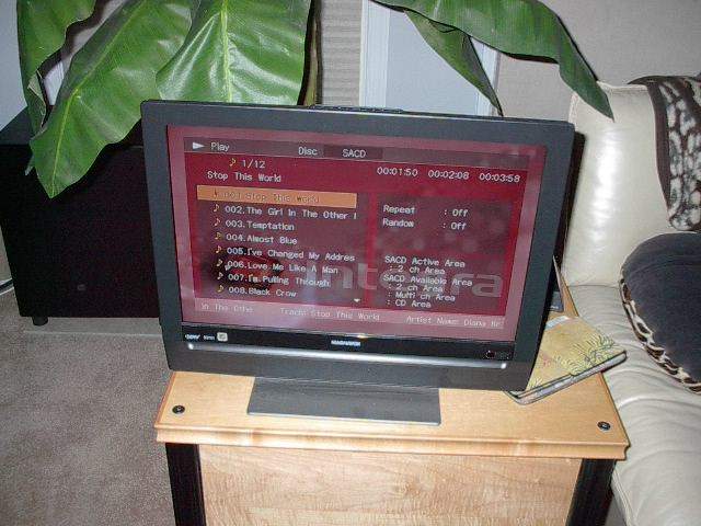

btw - the Integra DPS-6.9 also has a nice display of track read-out for those interested.  You can change the color on the menu too.  I have a 19 LCD about 7 feet from the listening chair (the first pic below is the entrance to the room to show the proximity of the LCD to the chair) which I main got for DVD-A menus so I would not need to turn on the projector.  I then hooked a camera to the front door and piped it all around (I have manual switch behind the TV) so I can see if it is worthwhile to answer the door and I also have the Marantz DV9600 universal going into it (to set-up things).  The 2nd pic is a read-out of what the DPS-6.9 displays.  So far, with about 45 minutes of listening, I'm happy with it.
