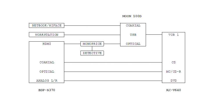

old_bassist
Re: Review: take SACD and BlURay Hirez directly to your DAC!!!!
« Reply #185 on: 6 Feb 2011, 09:06 pm »
Try this:
make sure the Sony BluRay player's SACD is set for PCM, NOT DSD.  And the 176 sample rate will not like your 96k DAC.
Thank you for the reply Ted. I have the BDP set to output PCM, and I am auditioning a Moon 100D DAC this weekend--it can do sampling frequencies up to and including 192 kHz. I think there are revelations in Phil's post from today. I wonder if the SACD / 176 / lights on but no sound issue occurs with the Atlona box the way it appears to occur with the Monoprice unit.

The Monoprice de-embedder is known to have an SACD / 176 / lights on but no sound issue. Does the same issue occur with the Atlona AT-HD577?
Thanks :)

I have the 577 and it seems to work fine with my BD-83 but that is only 88.2. One thing in the diagram posted is the optical from the de-embedder to the DAC. Most Toslink interfaces will not support above 96Khz, so even if you can get 176.4 from the Atlona or Monoprice it's likely it won't be passed.

« Reply #190 on: 8 Feb 2011, 07:33 pm »
Thanks--I don't recall trying coax from Monoprice to DAC. I will try that tonight and will report.
It would be great if I could get the Monoprice working correctly. The Atlona 577 looks like a cool gizmo and all but it would cost me over CDN $300.00. That would buy a lot of music!

old_bassist
« Reply #195 on: 8 Feb 2011, 11:44 pm »
Eureka! I ran Monoprice to DAC with coax instead of optical and we're locked and loaded on 176.4. I tried a couple of TOSlink cables including one from the UHF Magazine's store.
http://uhfmag.com/Digital.html
No love with optical, but rock-solid with coaxial. Happy camper now am I.
Thanks for the good info and for this great site!

Quite a few toslink inputs are limited to 24/96.. Wyred DAC being one.
