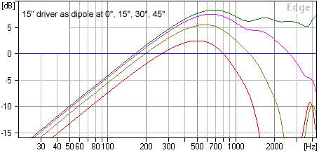

Do a simulation in Edge under 0°, 30° and 45°. That will show you what happens off axis.
Up to what Hz, would we get constant directivity from
 - a 8" dipole
 - a 6.5" dipole
Dipole CD is a function of baffle size and driver diameter. Again - do some simulations in Edge. They are really helpful to get a better understanding of what is happening.

When looking at results in the Edge, what constitutes CD – what dB gap between 0, and 30 and 45 degrees?
Thanks again
Rudolf
Re: 15" woofer at 1KHz?
« Reply #28 on: 24 Jun 2010, 11:10 am »
"Constant" is about dB gap width staying constant - not about absolute gap width values. In the diagram you see constant directivity up to 500 Hz. If you are more exacting, you would choose 300 Hz as the upper limit:
Above 500 Hz the driver starts beaming - the dB gap between angles becomes larger with frequency.
There are different sorts of constant directivity which are defined by the directivity index. Omni speakers would have a directivity index of 0 dB and dipoles have a directivity index of 4.77 dB.

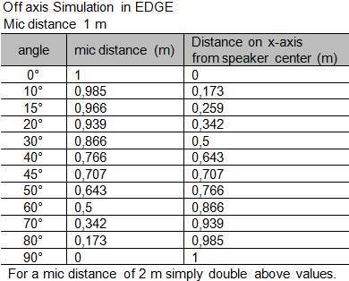

Ah, can you explain how to make the angled response in Edge? Maybe there's a new version out?
Guido
Rudolf
Re: Constant directivity
« Reply #39 on: 2 Jul 2010, 10:44 pm »
Hi Guido,
no new version of Edge. It is just triangulation. If you have a certain "mic distance" and move the mic sideways from the speaker center, you can emulate any angle from -90° to +90°.
I have done a chart with the angles most often used:
