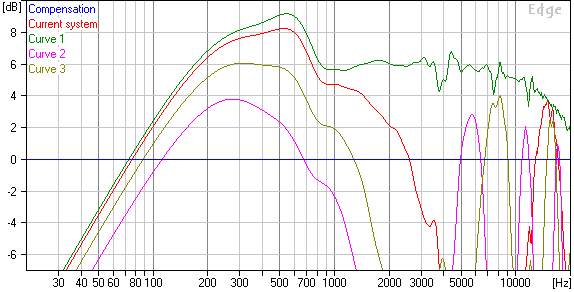

It's not about the on-axis response only. Look how a 15" driver on a 50 cm wide OB will radiate off axis:
The curves are 0°, 15°, 30° and 45°. Crossing at 250 Hz would be fine, 500 Hz acceptable. If you want to cross at 1 kHz, you need a driver with the same beaming character at that frequency. That has to be a horn or a waveguide.

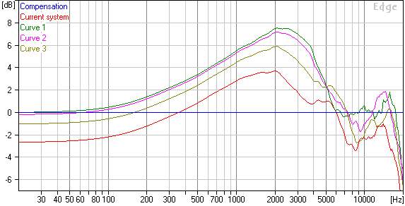

Tried to do a radiation pattern 0-45° for a 2" line source (monopole) on a 4" wide baffle of 75 cm length:
At 1 kHz the loss from 0-45° is 3 dB for the ribbon, but 8 dB for the woofer. No good combination from my POV.
You can easily try it yourself with the free simulation program Edge from www.tolvan.com/edge

Even when listening on axis, more than 50° of what you hear is indirect sound. You need to be concerned about off-axis response too.
What I am really concerned about is how you are trying to connect a monopole line source with a dipole point source. If you want to look into OB bass for those ribbons your aim should be a dipole line source with 5-10 drivers of 5"-7" size stacked in a vertical line IMHO.
