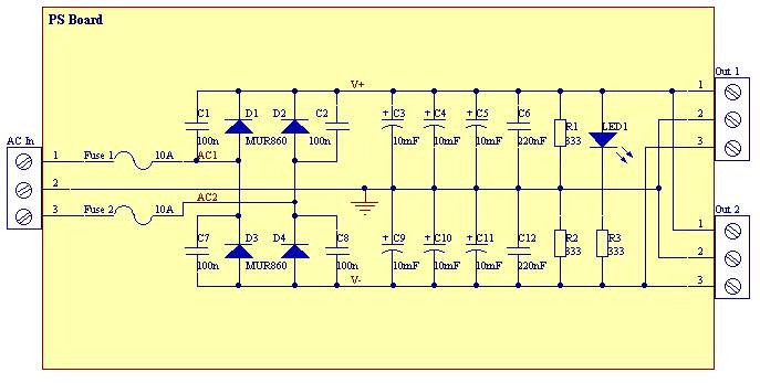

Won't know until I hook it up. May not offer any benefits at all, but the connex design as i said includes bypass caps, higher capacitance, and fast rectifiers (i think, hard to tell from the photos). Whether this translates to audible improvement remains to be seen, er, heard.
EDIT:
Here is a schematic for the Connex:
« Last Edit: 14 May 2010, 08:44 am by wushuliu »

Thanks for posting the schematic as well. I suppose you don't know what brand of parts are used.  You will have to let us know when you get it!
At any rate, it looks like the AC in is identical to what's on Tom's board, so this means that it definitely accepts dual secondaries.
Any thoughts about the use of dual fuses at the AC in? (I guess this also means you don't need a fuse at the IEC socket?)

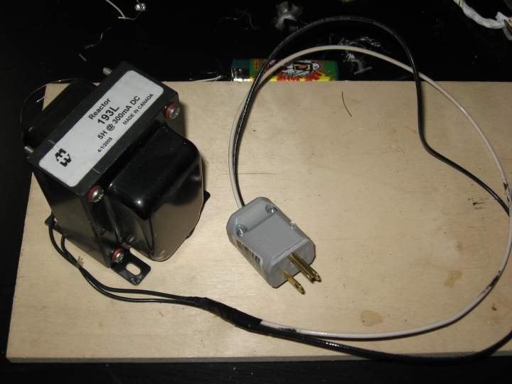

I know this is slightly OT but I just want to put a big fat recommendation for the 193L Choke-as-power conditioner Diy tweak that Alan Maher whipped up a few years ago.
If you don't know what it is. It's just a 193L filter choke that you can get from PE or Radio Daze
http://www.parts-express.com/pe/showdetl.cfm?Partnumber=122-380%20%20%20%20%20%20%20%20&FTR=193L&CFID=28024228&CFTOKEN=42159699
You put one wire into the Line of an AC plug (that you can get from HD or anywher), the other into the neutral... and plug in the wall. That's it.
As I understand it, it's something like a really poor man's Richard Gray Power Conditioner. There are some posts on AC about it going back a long way, and several years of steady testimony on audioasylum for those who wish to see if it's on the up and up. What's reassuring is that if you're TV is in the same circuit you'll see the effect it's having and your audio will go through very obvious roller coaster as it settles in. And yes, it's safe, and will not damage your stuff.
When I plugged one of the several I already had directly next to my classd amp (insert poetic verbiage here)! And the best thing is, it's right there in your face. Nothing vague about effect it has. I rank it far above upgrading the PS caps or wire or... It's $50 well spent.
Of course, be careful as always w/ anything AC related.
Anyhoos, been meaning to mention this for a while. It rocks the bells.

I guess one way to avoid the amp to work at temperature within the limit originally designed is to find a transformer that provide higher current (as supported the bigger caps) but with output secondary voltages recommended by Tom??
Since there are two fuses on the PS board already, I am sure that one can omit the AC line-in fuse since the amp and PS borad are downstream of the fuses.  But then again, the transformer would be on it own in case of a huge surge.
May be I missed it, would you have a link (not the PE one) to the 193L filter choke? I would like to learn more about this "gadget" and how it works.  Thanks!

Here's an old link discussing the concept and how it came about.:
http://www.audiocircle.com/index.php?topic=10310.0
Can't find an exact Alan Maher explanation for you because there are too many posts about it here and audioasylum to weed through, but here's one that should do:
http://db.audioasylum.com/cgi/m.mpl?forum=tweaks&n=144960&highlight=193l+filter&r=
EDIT:
Please post a pic of how you wired this bosrd up.
I am odering one for my SDS254
Thanks
