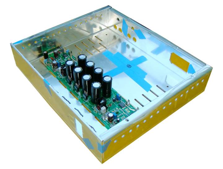

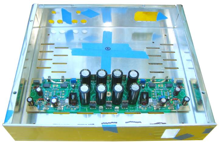

Folks,
I have a prototype case for the NAKSA 70 now complete.  Here it is with a NAKSA 70 stereo module in the correct position:
This case is very, very good.  It's made in monocoque from one sheet of Al, and requires only a 1mm steel top cover.  It's purpose designed by Graeme, a good and generous friend, and I have pulled the trigger on a number to be produced in the next fortnight.
This is, as I've said, a prototype.  The final will have:
1.  All sharp edges linished
2.  Semi-gloss, quality powder coating
3.  All holes and slots correctly position for standard production parts which may be ordered or otherwise with the module
4.  No further reworking required;  a complete DIY kitchen table assembly, just supply Transformer, which can be up to 120mm in diameter.
The more I listen to the NAKSA 70 and 100 power amps, the more convinced I become that these are just wonderful amps, very musical with terrific resolution and driving bass.
More later as the batch is made.  I will photograph and display here the build.

Dimensions for the N70 enclosure are 320W x 250D x 65H, which is 12.6W x 9.85D x 2.56H.
Cost at this stage will be ballpark $USD125 fully linished, drilled, tapped, powder coated.   Nutserts will be used to hold the feet and top cover.  A large reinforced, dimpled anchor point will secure the transformer.  The alloy used is 3mm thick, almost 1/8", and very strong.
The yellow you see is simply sunlight reflected color from the stand on which the box was placed for photographing.
Those who order the box with their module will have the module already installed, ready to connect up.  The case is the heatsink, having even more radiating area than the large cast heatsink I normally use.
I'm struck by how strong and light this box is, quite amazing.  I think a lot of people have been waiting for this enclosure!
