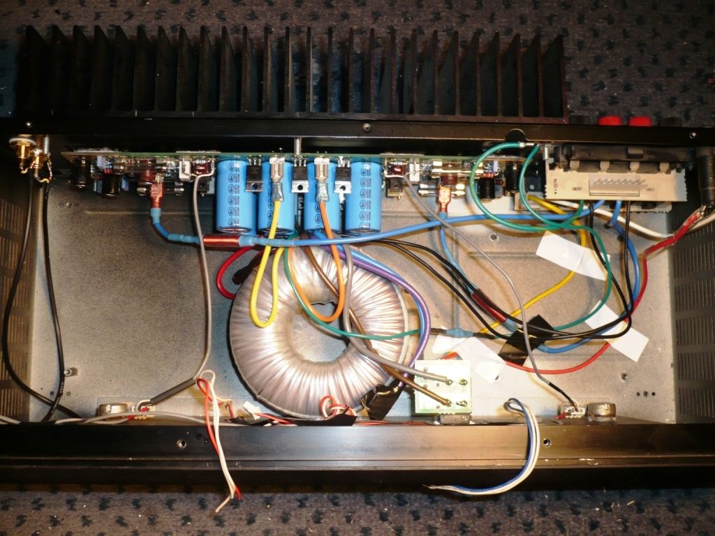

Thanks Hugh, as long as I can stay off the drink, hic  :eyebrows: Enjoying a nice bottle of Sauv Blanc from Marlborough Estates - a little vineyard in a little island off Oz, I believe   :D
Anyway, layout looks OK to you?

John,
Looks fine!!
However, you may find that using an existing amp case for a new module takes much more time than you had planned, because all sorts of controls, wires and components are just slightly different, which can be annoying.  You finish up with something pretty good, but lots of holes in the case you will never use.
However, nice layout, compact, and clean.
Hugh

Yea, I know that dilemma very well - trying to shoehorn something into an ill-fitting case can be a nightmare but this was just so damn close a fit that I had to do it & it appeals to my frugophile sensibilities.  :D (I smile a lot more when I've had a drink or two  :lol:)

OK, an update - I started a thread over on DIYA to document the build & after the usual argy-bargy (I swear that place is full of sociopaths) it has now settled down http://www.diyaudio.com/forums/solid-state/170341-new-aksa-amplifier-build-pics-naksa.html
So let me bring both threads up-do-date:
I've just about finished - everything done except the leds to be connected ( these are the wires hanging over the front - there are 3 wires for two leds on each side - I'll only be connecting one led each side.)
This turned out to be a really neat fit for the Naksa board - there are no holes or awkward fits in the final build. I will make a decision about the final placement of the toroid once I have listened to the amp. If it's current placement has some sonic downside, there is room over on the right where the speaker out & PS -in connectors are located.
I will look at an LDR lightspeed vol. control (this will require a small 5 or 15V PS - I'm sure I have some of these) & also maybe re-doing the front panel into something more suited to the hopefully high quality sound of this amp - if it sounds special, I want to make it look special. Any ideas?
I will be powering it up tomorrow.
Edit: One question about lead dress - now that I look at the pic, should I re-route the three ground wires up to & along the back panel rather than crossing the PS AC leads - I know the answer is probably yes! I've run these PS AC wires along the bottom of the case taped down with white tape.

Have it working now with my test rig but no time to move it to a proper configuration to evaluate its sonics.
I will be doing this tomorrow & having a good listening session!

Excellent work, John!
We await your assessment of the sound!
Thanks for the piccies......
