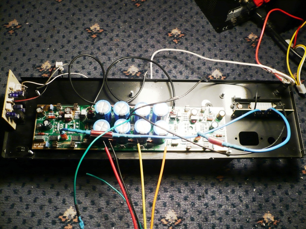

Progress Report:
I got my Naksa pcb from Hugh just the other day - flown half way around the world in about a week, fantastic - beautifully made & soldered. So compact - a work of art.
I have been planning my construction.
- ordered a 300VA 30-0-30 toroid trafo
- I have a nicely suitable donor case which just fits neatly - it's a Samson Servo 550 stereo studio amplifier of 275 watts per channel. The heatsink is a perfect size for the Naksa pcb & the rest of the case will neatly hold the toroid. (The existing beefy EI trafo is 54-0-54 may well suit a 100W Naksa?). The dual mono pots will be used to eventually control a lightspeed vol. control. The balanced inputs will be changed to SE inputs but that's all that really needs changing. As I suggested to Hugh, this might be a good second-hand buy for Naksa builders - it may be less than the cost of a heatsink alone never mind the case. (I picked up 3 of these at my local recycling centre :))
- Once the existing pcb is removed (good parts source - 6*SC5200 & 6*SA1943), I will be tapping the heatsink for the Naksa board - hopefully today
« Last Edit: 15 Jul 2010, 11:14 pm by jkeny »

That's a great idea, a very clever way of buying a nice, elegant case.  That Sampson is a bargain from a recycling center, I must check mine out - not that I need any more electrical equipment in my workshop, hell, I can hardly get in as it stands......
Thanks for the pictures, we will watch with rapt fascination just how you add the NAKSA to this case!!

Ok, just down from my work room with an update. Tapped the heatsink & got as far as mounting the Naksa board on the heatsink & back panel. Tomorrow I'll connect the xfmr, vol pots & outputs - should be listening then.
Couple of problems - all my own making - so progress was slow: Drilling & tapping went surprisingly easy - this is the first time I have done this!. One worry though, the holes are pretty close to existing tapped holes & mica washer sits over these pre-existing holes - cuts down the heat dissipation efficiency somewhat but hopefully it won't be a problem.
All my spacing washers fell out when I tipped the pcb to offer it up to the heatsink - these are awkward to put back in between the output devices & the underside of the pcb. Hugh, it might be an idea to somehow stick these in place when you are assembling the board.
Pics attached:
Heatsink Tapped
Naksa mounted on back panel
Naksa mounted on Heatsink
Samson Case Full & Empty
AKSA
Re: New Naksa Amplifier! Quick Initial Impression......
« Reply #116 on: 15 Jul 2010, 11:32 pm »
Hi John,
Couple of points I'd make here from past experience!
#1  If you drill and tap any hole for mounting pcbs, always countersink the hole after drilling and before tapping.  This removes any chance of burrs breaking through the mica washer at fitting.
#2  Tapping is best achieved into cast or extruded Al with kero, meths, WD40, or some other cutting fluid.  Just a few drops on the tap will make all the difference.
#3  After this operation, go over the mating surfaces with wet/dry sandpaper grade 250 to remove any burrs or sharp peaks.
#4  Thoroughly clean after the tapping and sanding operation.  Allow to dry.
#5  When fitting semis to flat surfaces with mica washers, first grease up the washer ONLY, BOTH sides.  Then, carefully position the washer on the heatsink, press hard with the finger tip to adhere it to the heatsink.  Then turn the heatsink so it is vertical, and move the NAKSA pcb towards the heatsink in the vertical position with bolts and washers held horizontally in place by gravity.  First gently screw in the leftmost bolt, then the right most bolt.  This will locate the board correctly over its holes on the sink.  Then, using a very small jeweller's screwdriver, engage the driver stud, an 8mm bolt, and screw it in four turns.  Then guide the bolts for the inner semis, once in, turn the assembly so the pcb is now uppermost and horizontal, and screw down the four bolts carefully until they are firm.  Recheck that the mica washers are square, properly aligned with the longest dimension of the heatsink.
#6  Now, using a beefy philips head with a shaft diameter not exceeding 4.5mm, screw down the driver fairly tight.  Not too tight, this is only Al, mind!
#7  You can now tighten down the four semis, ensuring that washers lie towards the center of the board and do not foul the earth track on the outside of the pcb.
Once this is all done, inspect the semis between the pcb and the heatsink to ensure they sit flush against their washers and heatsink, and double check all bolts are tight, but not so tight they risk pulling out the thread.  Holding the pcb vertical at assembly will prevent the washers falling out;  sticking is not required in this situation.  Using the above approach you will ensure good thermal contact and electrical integrity, with not too much heatsink paste spilling out!
Hugh

Thanks, Hugh, I'll go over my work tomorrow - I did check that there were no burrs or edges - everything felt smooth to the touch - didn't have 250 grade sandpaper.
I take what you're saying about the washers - still if they fall out for any reason, they are a bugger to get back in & lined  up.

Not much progress, I'm afraid - well it is Friday  :icon_lol: & I'm now having a glass or two of wine which I find is not conducive to soldering or planning layout.
Anyway a pic - I've wired the outputs - both speaker outs are on the right side  of the case so one lead goes across the board which probably isn't optimal.
I have orientated the Naksa so as the inputs are on top - I'll eventually put lightspeed attenuators next to the inputs but at the moment the Balanced inputs are on the board on the left - I'll change these to SE inputs.
The PS toroid I'll probably mount just in front of the power section of the Naksa
Any/all comments appreciated (as long as they're clean  :D)
