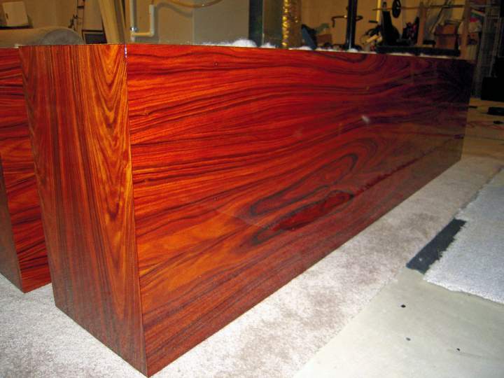

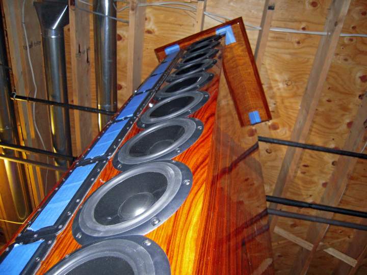

Been at it for a few winters here in Michigan building these.  Followed Danny's plans, with a "few" modifications.  Sealed every piece of the MDF, and beveled all holes in the braces.  Went to Oakwood Veneer here in Michigan and had the chance to be picky in choosing (4) matched sheets of 22m Premium South American Rosewood Veneer.  Not cheap stuff when you buy that much.  I spent a full weekend matching the Veneer patterns before cutting and glueing.  Used over a gallon of poly (with endless sanding one side up at a time to get a mirror finish), and used No-Rez through-out which I table sawed for a custom fit. No Rez buggers everywhere! Crossovers are in their own Veneered enclosures topped with Evonic Flourescent Plate Glass Tops, Platinum Caps, Bi-Wiring, and internal shielded LED Light strips - after all this stuff is too pretty to stuff inside the speaker box.  I will mount the crossovers on top of each speaker for a real treat when looking down on them from the upstairs balcony.  Yes - the one pic has the speaker upside down so I could center the bases - ever try to lift one of these monsters by yourself?  Ran out of wire which I just ordered from Danny, but should have them up and running soon.  Sure hope they sound as good as they are looking!  More pics will follow.

Finished and breaking them in.  Will add some sound treatment behind them, since they are somewhat close to the wall.  It took (3) strong men to bring them up from the basement.  Dear God do they sound good!  The LEDs in the crossovers add a nice touch.  The last pic is my "Housewrecker" Sub I built a few years back with dual "Titanic Mk III" 15" subs driven with a Europower 2500W amp.  Together with the LS's there is some serious freaking bass in the house.
