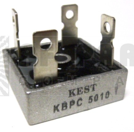

I would like inform the impressive low price of a powerful SS Rect.
Just $3.50 each for 50A & 1000V and it dont need heating:
https://www.rfparts.com/kbpc5010-kest.html
