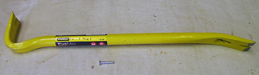

Speaker Removal
The two 5" mid-range speakers are tightly fit into precisely cut recesses. The only way to remove them is to screw a large wood screw into one of the mounting holes. Pull on the screw and the speaker pops out. I ground down the screw tip so it wouldn't grab the particleboard box. The crowbar was a bit of overkill but it worked like a champ.

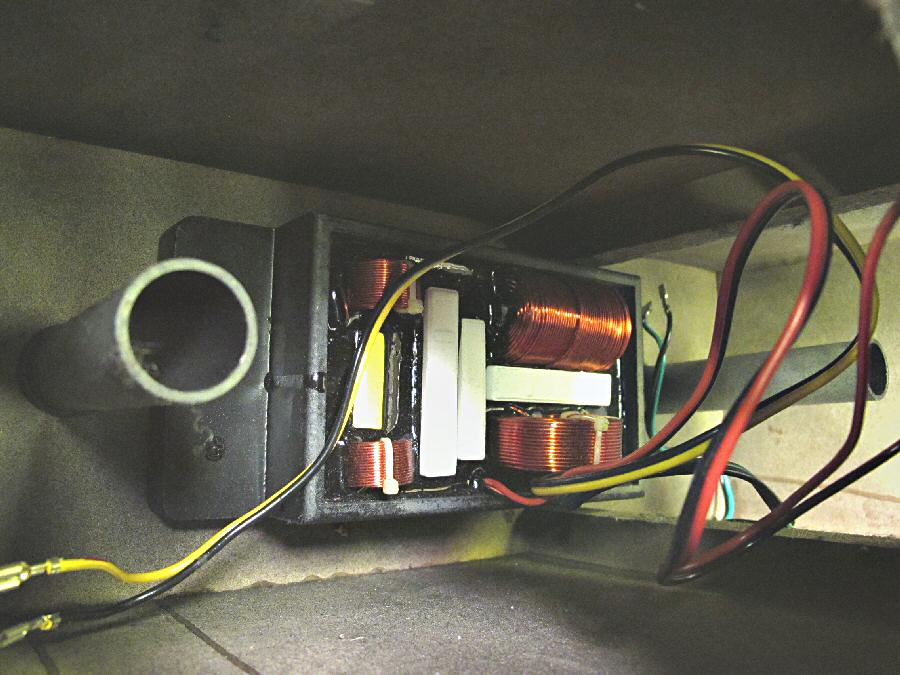

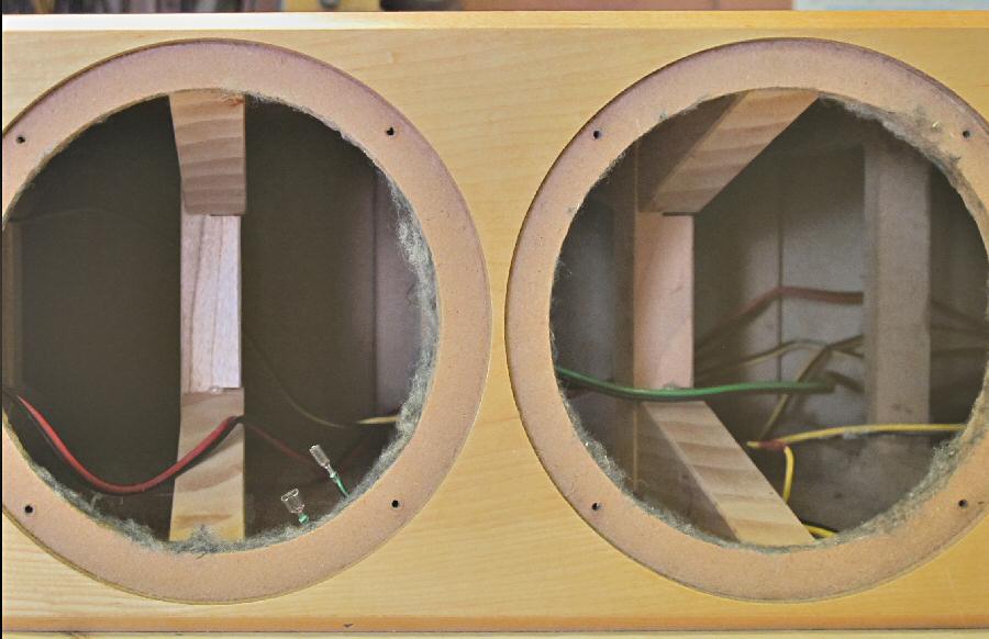

What's Inside the Box?
Not much. A little thin felt, some fluff as seen on the left, and minimal bracing. Nothing is glued so all the padding is just flopping around in there.

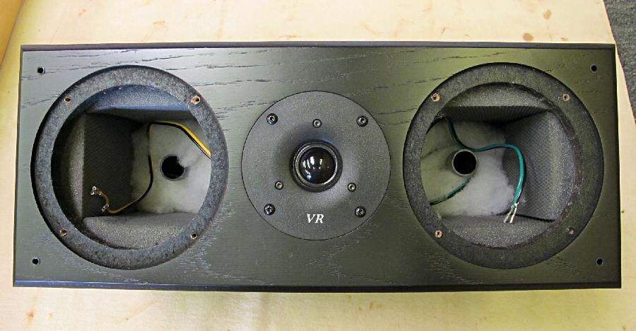

No Rez Installation
This was so quick and easy no pictures are required. Cut, peel, stick. I covered the 4 sides, put the rear felt and fluff back in and buttoned it up in less than an hour.

I finally plugged in the LCR-15 and was not impressed. Indiansprings dropped the speakers off at my shop and I never listened to the stock LCR-15 but it must sound pretty bad if the No Rez model was uninspiring. The speaker is tonally similar to the VR2 but there is a definite chestiness to male vocals. Music has a nice thump but since this is a center speaker designed for vocals the LCR-15 needed a little emasculating.
I'm a big fan of Kapok. The material is light as a feather but has the ability to damp resonances and standing waves much better than Dacron, I'm guessing by a factor of 2:1. A little goes a long way so I stuffed that little box full of Kapok. Then taking a tip from Frank Van Alstine I damped the speaker baskets with plasti-clay.
The results are a speaker I can live with. Tight and tuneful, no chestiness or low bass to speak of, exactly the qualities needed for a center speaker. I consider the modifications a complete success.

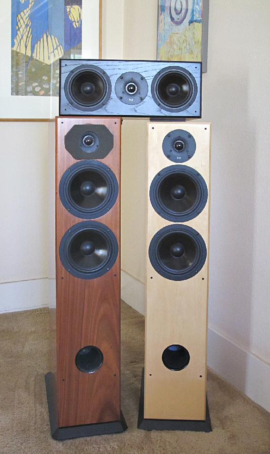

Below is the LCR-15 sitting on top a couple of VR2's. The left speaker is mine, the light maple is the speaker I recently modified for Indiansprings.
Readers not familiar with my VR2 mods can read more here and here. Below are a couple of photos, the first are the braces used in one speaker and the second is a new installation photo. The top section now has a brace every 3". The bottom section has a larger brace mid-way with Richlite glued above and below the brace (4 pieces total).
