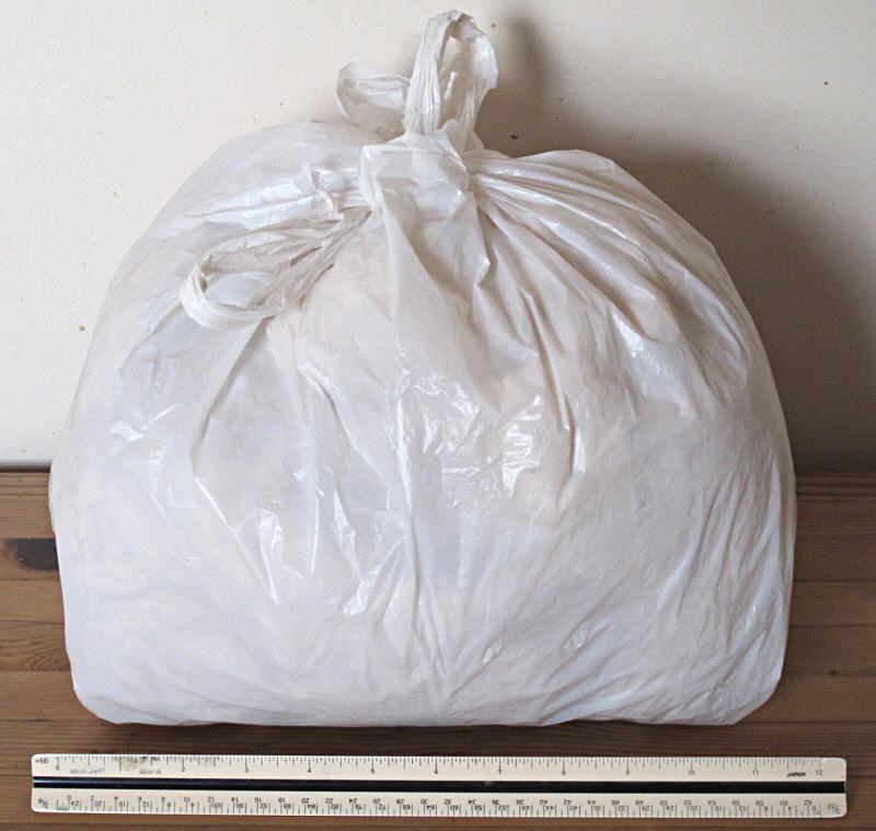

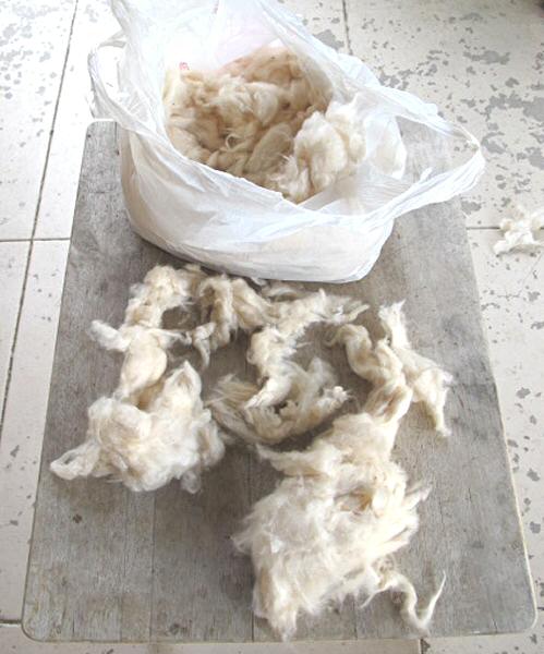

... as a stuffer for bass...  How far does a pound of this stuff go?
Bass are not very big so you could probably stuff a couple of dozen.  :)
The kapok is loose and fluffy, I used in combination with the Dacron. The stuff will be blown out the bass port with loud music which is really cool to watch. I use it to fine tune a speaker instead of filling a module, usually in the upper chamber. A port screen might be necessary with the VR5.
I'll weigh the bag this weekend, I lost my little postal scale but can use a friends scale when I see her on Saturday.
Wayne

This volume of Kapok weighs 4.5 ounces, it would fill 3 LCR-15's, maybe even 4.
Wayne
