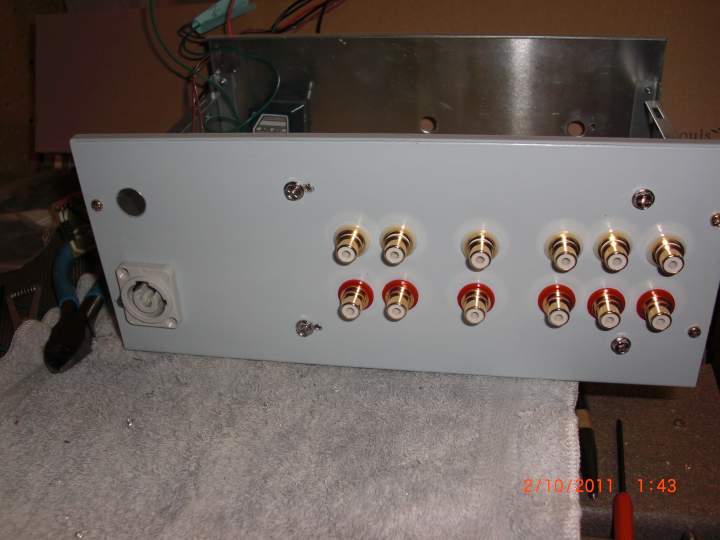

Here are three photos of my build in progress. Comments and suggestions are welcome.
TrungT
Re: DIY Dodd Buffer
« Reply #825 on: 10 Feb 2011, 06:59 pm »
Looking good.  :thumb:

« Reply #826 on: 11 Feb 2011, 03:56 pm »
Another quick update. Only a few more wires to shorten and then we should be ready for a test run.

A general question for the group on the Neutrik plug. I'm assuming a two conductor wire is fine for this application.
TrungT
Re: DIY Dodd Buffer
« Reply #831 on: 11 Feb 2011, 09:51 pm »
L (+)
N (-)
That's all
 :thumb:

I have three 7 ah batteries. If this thing actually works after everything I've done to it, I'll probably wire the batteries in parallel.
Atlplasma
  • Posts: 963
  • Just off the boat
Re: DIY Dodd Buffer
« Reply #833 on: 11 Feb 2011, 10:51 pm »
I put the buffer into my test system and have MUSIC!  :thumb:
I'll have to get it into my main system ASAP!
