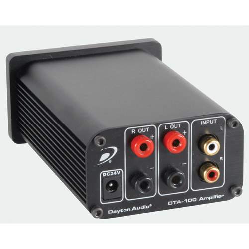

People have been waiting for the Parts Express Dayton DTA-100 amplifier using the Tripath TK2050 chip, and it is now finally in stock.  As it has just become available, there is a lack of user reviews.
I haven't heard it yet, but it looks like an attractive buy for a 30W/channel Tripath amp @ $100.  Like all Tripath amps with a switch-mode power supply, it would probably benefit from a better linear power supply.
http://www.parts-express.com/pe/showdetl.cfm?Partnumber=300-383
Edit:  I just noticed the speaker posts are banana only (fine for me as I use BFA-style banana plugs exclusively), but wanted to point that out for those that might want to use spade connectors.

I agree with srb that for the money, the Tripath 2050 for $100 may be what you're looking for.

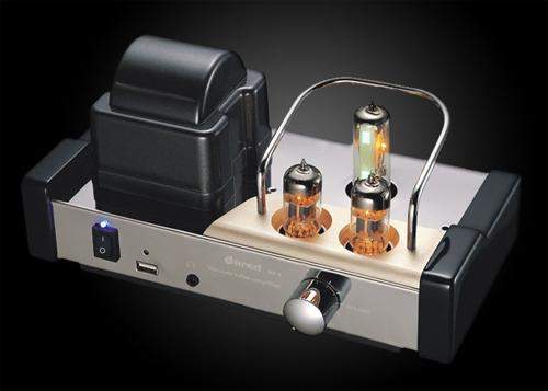

What do you fellow audiophiles think of the JV5 Tube Amp?
(http://www.aloaudio.com/store/index.php?main_page=product_info&cPath=1_4&products_id=374)

The ALO JV5 was manufactured by Dared as the MP-5.
It was also sold with a companion iPod dock (and no USB input) by Sonic Integrity as the TubePod and from TL Audio as the Fatman iTube ValveDock.  In ALO's product listing for the JV5, when they refer to "No goofy graphics printed on the amp", they were referring to the Fatman version.
Of course, it only has 1 analog input and 1 USB input, selected by a toggle switch on the rear panel.  I have not heard one, but with all the variants out there, I would imagine one or more AC members have.

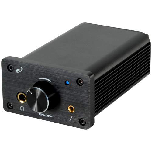

Today I got the Dayton DTA-1, and the Klipsch F1 speakers are connected.
The source is line-out from my iPod and while I write this post, we enjoy listening to Eric Clapton's 'Unplugged' recording. The volume knob is at 1 o'clock, and it's loud enough. What a pleasure!
I did mind your advice with regards to more power or tube amps, but with this small purchase I bought myself some more time to consider the options. Perhaps I get a $400 tube amp after another paycheck, or perhaps I get the DTA-100 when it comes available.
And with digital transport in the future I have something to look forward to and appreciate.
