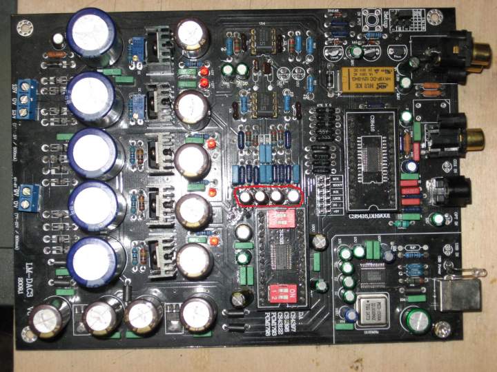

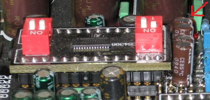

The Goal : get rid of some bypass/filter caps next to the dac, jumper them, replace output caps
Startin' w/ these guys
Now if your board has different color capacitors or slightly different values, don't matter. There'll
be 4 of them and they need to go.
Important: This solder on this board is finicky. I do not recommend applying the soldering iron to the bottom of the board. In my experience the pads tend to melt or just disappear into the board. So I recommend working only with the top side.
What I did was rock each cap back and forth until they broke off. (Given the finickiness of the board I wouldn't worry about 'saving' them so you can put them back in. It'll be more trouble than it's worth unless you're a pro with an adjustable temp workstation, etc.)
Then I bridged each side of each cap positive and negative side with some solder. You can also use a piece of wire, etc.

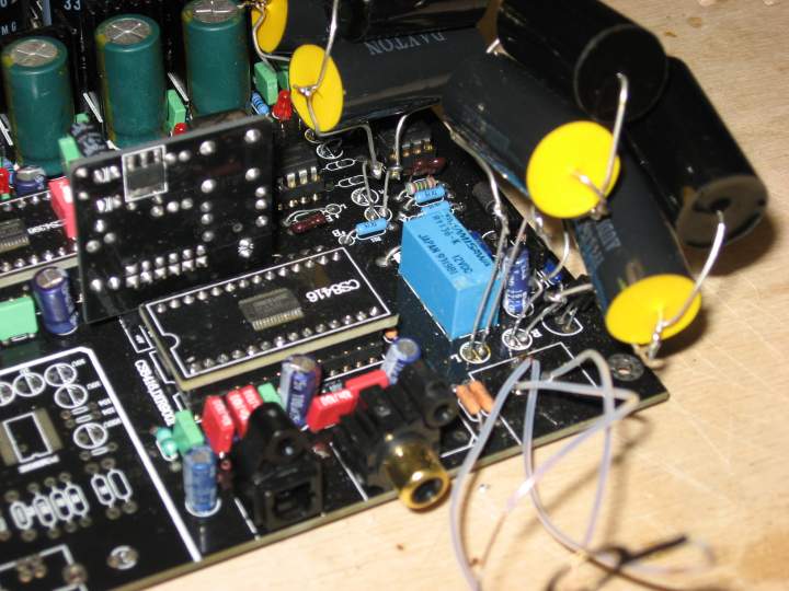

Next, Output caps
This may be tricky w/ the rca inputs in the way. I recommend pulling those out of there as they're very flimsy, and using some decent rca inputs and wire. Chances are to accomodate an enclosure you'll have to anyways...
Output caps can be replaced with the cap of your choice. The holes require small leads, so I clipped off thin leads from spare resistors and soldered them to my cap leads.
In the rear you'll see I also replaced the caps before the second opamp. Whether you want to try this is up to you. Since the layout of these boards seem to change every six months, some boards may not even have them.
That's it!
I found this mod to be far superior to the stock sound. Clears things up a lot.
You can also try some of Dave's mods below: getting rid of those 4 bypass caps, getting rid of the second opamp and jumping the bypass caps that sit before it. Jump the pins to keep mute relay (see his post), and losing the output caps altogether.
This is a good option as it doesn't involve replacing any of the caps, just pulling stuff out and jumping with wire, etc. And losing the second opamp is a plus

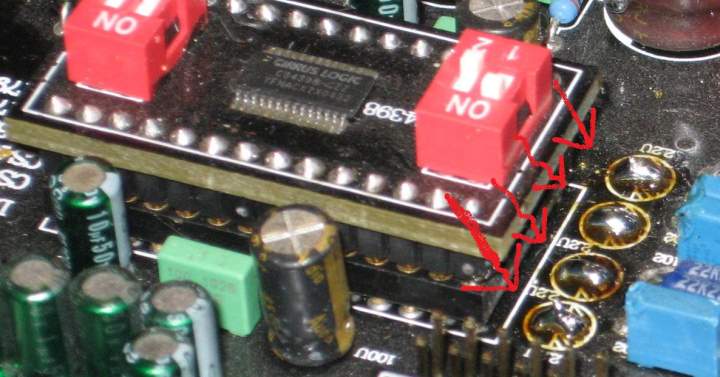

You want to solder in the 4 signal wires. They will go the transformers and from the transformers to your RCAs
In the Opamp mod section I showed the 4 Bypass caps by the dac chip that were tossed. Same
applies here. However, instead of jumping them we will be drawing the audio signal.
From Left to Right the signal goes: R-/R+/L+/L-
You will only need to deal with the positive (unstriped) side of each one. Like so:
I still recommend rocking the caps to break them off, thus avoiding full desoldering on the bottom side of the board. Then use tweezers to pull out the leads. Much easier and reduces iron time on the pads.
Also, the dac chip is removeable. So if you feel a little cramped during this part, gently pull up the dac chip from its sockets...
When you're done, should look like this:
That's it for the board. Phew. Now you can be butterfingers all you want with the output transformers!

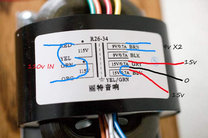

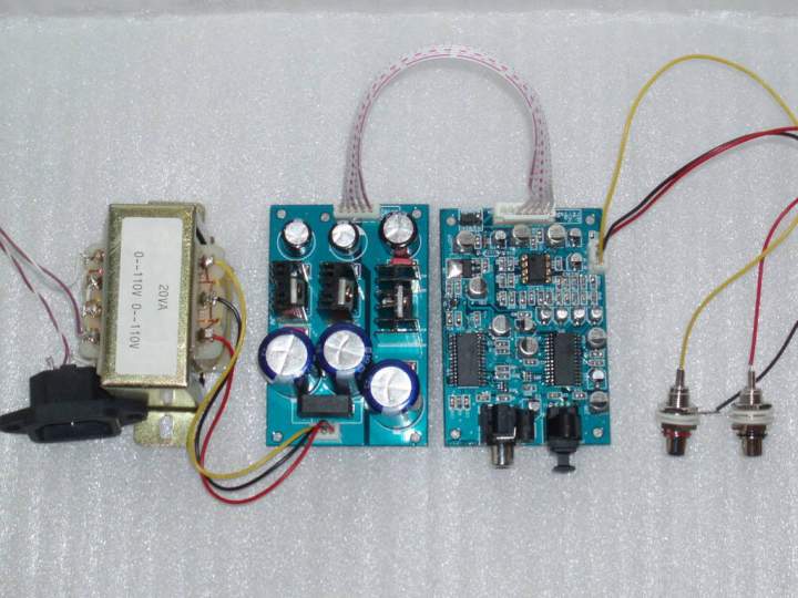

Power Supply Transformer
The first kit comes with a R-core R26-34 transformer for the power supply. It is also available separately on ebay. It's a mad jumble of wires but you'll only be using some, not all.
Note: The wiring in this post pertains to US/115v only!

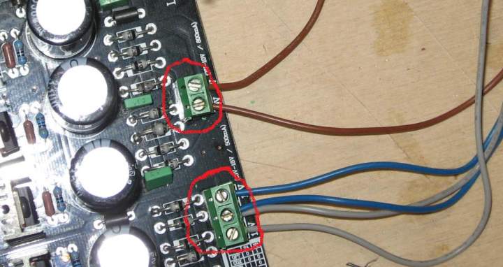

Stock/Opamp mod wiring
On the board you will see at the back two inputs for 7-10v and three inputs for (12 to) 15v-0-15v
For the 7-10v you will use the two brown wires
For the 15v-0-15v you will use a grey at one end, blue at the other, and BOTH in the center
Here is a great diagram  provided at diyaudio:
The remaining wires on that side should clipped/taped up and tucked away
For Output Transformer/No Opamps Mod
Since you will be bypassing the opamps completely, there's no need to worry about the 15v-0-15v
side. Nip/Tuck those away and just wire up the 7-10v with the two brown wires!

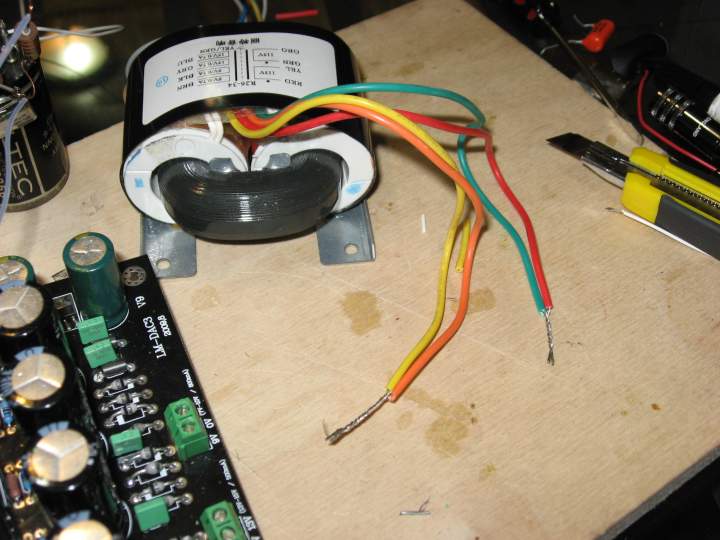

Primary/Mains
OK, please look at the diagram above.
Wire the Red and Green together for your LINE voltage
Wire the Orange and Yellow together for Neutral.
Remember this applies to 115v/USA only
You will want to add the Power switch to the Line of course.
The rest of the setup is up to you.

I went ahead and took some new pictures.  I forgot to shoot the new diodes, but, hey:  they are just diodes :)
This is an overview of the mule
This captures most of the mods in one picture
USB input area stripped.  I removed the 3-pin regulator in the bottom of the board
The replacement RCAs - Canare and Gigawork
I auditioned opamps:
    AD826 - forward and hard, almost brittle sounding
    OPA2134 - smooth but not very articulate
    LM4562 - woofy and vague sounding, hard to define some instruments especially in the mid
          to upper bass
    Twin OPA627 (Gigawork) - as always very good with nice bass and smooth yet detailed, very
          dynamic
There you have it so far.  The journey will continue............................... ......
Dave
