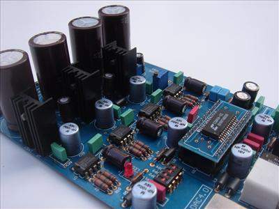

here's another cheap one that's just come out. Haven't heard it, but it doesn't use opamps in the
output stage like the above and the seller seems to have good quality dac's (one of which is on the way). For the
money it can't hurt to try, and you can let us know what you think!
http://cgi.ebay.com/Special-offer-TDA1543-4-DAC-4-0-NOS-DAC-Kit-CS8412-/220589925703?cmd=ViewItem&pt=LH_DefaultDomain_0&hash=item335c2f2547
Hey!
    I have this DAC in my system right now. Bought from this seller, great seller by the way. :D
    This DAC use 4 TDA1543 DAC chips running in paralleled. The output come directly off those chips. There is no opamp or buffer after the DAC chips. Simple! I like it.
  The DAC uses lot of good quality component despite the price. Still I only did 2 upgrades to it. 1. Changed diodes to Schottky type 2. Changed the output caps (22uf) to Russian K73-16 22uf 63V with Jensen PIO Copper as by pass caps.
     Definitely the output cap upgrade made the biggest improvement. The stock caps sounds horrible. But I know NOS DAC so that was the first thing I looked at to upgrade.
    So far a great NOS DAC. But not for everyone. It won't do detail especially in the high like 24/96+ DAC. But I'm a fan of NOS DAC of which I feel sound more analog playing Red Book CD :D I found most 24/96+ DAC sound unease especially in the high that sometime can sound hyper unnatural. Of course they are some exception of good 24/96+ DACs out there.

Hey!
    Anyway, I will take some pictures and post them here soon.
Take care,
Buddy :thumb:

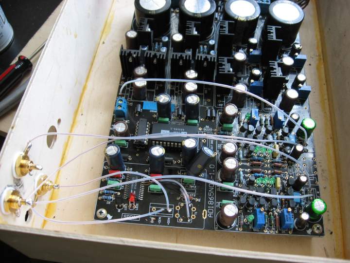

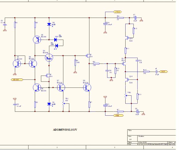

The AD1865 DAC is up and running. I've more or less followed the Lampizator mods, plus a few extra. As has been noted both on the Lampizator site and on diyaudio w/ the Andrea Ciuoffoli DAC (which the ebay AD1865 is partly based on) the sound is a little dark. I didn't listen to it stock so I can only imagine it's even more so out of the box. However, all the mods have opened it up some. It's a very different sound from the gigawork and I will need some time to really decide if I like it or not.
It does have a more 'natural' tone, more intimate, the HF is slightly rolled off at the top. The bass is very prominent. It is definitely more balanced tonally than my gigawork. Whether this is due to the values I used for the gigawork/tranformer mod or just inherent in the DAC, I don't know, but the AD1865 certainly wins in that regard.
The gigawork is slightly more on the solid state sound side of the spectrum. The AD1865, on the tube side. I think that's a quick way to sum it up. More info and thoughts to come.

Absolutely!  Any time... I play well with others (mostly see: http://www.audiocircle.com/index.php?topic=79128.new;topicseen#new ) and I share my toys.
Dave
Hey Dave, I've been listening to the AD1865 DAC I mentioned above and it' very promising so far. I really like it, but I am sure it can be improved. My biggest gripe so far is it's a little recessed in the HF. Anyhoos, I'm no expert on this stuff but usually a place to start w/ mods are the output caps. I notice with the schematic that the jfet output stage has a 100 ohm resitor followed by a 47uf cap. Is this some kind of filter? Any way to alter these values to benefit? Just curious... :scratch:

Thanks for your thoughts Sheldon.
I have just replaced the Panasonic FCs in the AD1865 DAC w/ Os-cons, and clearly it's what I should have done in the first place; the 'dark' sound is all gone and what I am hearing now is really, really good. Over the next few weeks I'll compare the two DACs. I think they appeal to different tastes. But this AD1865 I think just might hold it's own against the Gigawork w/ tranny mod...
playing w/ dacs is fun. 8)
