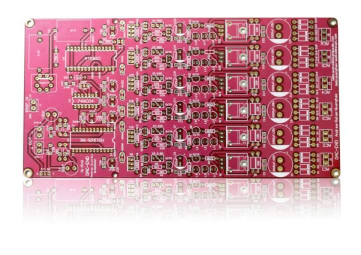

Another option that I wish existed before I bought my dac is this:
http://quanghao.com/product.php?id_product=9
It's an AD1865 board incorporating the Salas (of diyaudio) shunt-reglated power supply. The DAC circuit should be similar to the rainbow as they are both based on Andrea Ciuffoli's design. The Salas PS gets kudos and is guaranteed to be far far better than the rainbow design. And you dictate the parts quality, so end result will be in your hands.

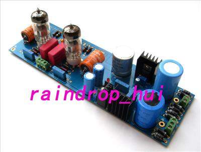

For the IV stage, a tube-based design is also offered on that site - but another option to go easier on the wallet is rainbow's tube IV stage:
http://cgi.ebay.com/DAC-I-V-conversion-module-SRPP-tube-module-/320572208796?pt=LH_DefaultDomain_0

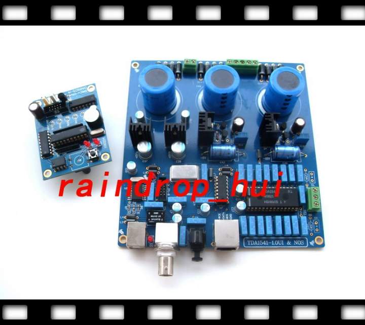

Well I broke down and got one of these guys today. It's a new offering from Raindrop and is exactly what I've been looking for in the TDA series to try out (I'm currently listening to the little Muse, which I've written about in Cheap and Cheerful): 1541, NOS, passive output, decent PS, and no frills. Straight, no chaser. I'll for sure put in new bypass caps by the chip. It takes USB, BNC, optical and I2S.
All these  DAC flirtations may seem impulsive, but I think this is a 'golden age' of sorts for diy audio and these kinds of kits/boards don't have that long of a shelf life. For a fraction of what I would pay retail I can decide for myself what DAC 'sound' appeals most: upsampling/OS like the gigawork, straight OS like the TDA, or something in between like the AD1865?.. And you can't beat the price ($110 shipped). My only worry is that the TDA chip may be fake. Should only take minutes to set up, aside from the usual enclosure headaches.
