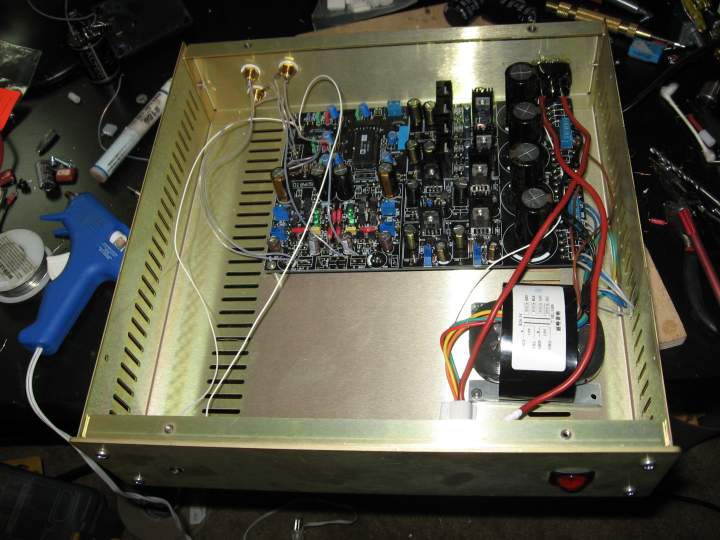

AD1865 DAC Update:
I have replaced the diodes by the power supply w/ fast 1A Schottkys (thanks Dave!), swapped out half the resistors in the I/V stage for PRPS and dales and half the caps for Elna Silmic II.
Here's the deal: At this moment, I have glimpsed audio nirvana. For these few moments I know why some of us audiophiles just keep on searching, keep on striving, spinning around in what seems like circles like dervishes. Because when everything falls into place and the music opens itself to you, it is a kind of bliss.
I reached that tonight w/ this dac. I would never have thought I would. Even this weekend I was pretty set on sticking w/ the Gigawork with the tranny mod. It just had a more open and engaging sound overall even though the 1865 sounded really, really good.
After swapping out those parts tonight, it's a whole other story. I've been wondering why the Lampizator article waxed so effusive about this dac kit. I mean, I was impressed but not overly so. But now I get it. If his output stage is indeed better than the kit's, I get it.
I'm going to give it a day or two. Maybe I'm just in a mood, maybe the full moon is out. Maybe it's the new xo in my speakers or A/C cleaning stuff I've been messing with.
Right now...  :o 8) :eyebrows: :wine:

re-reading your post I'm assuming when you say primaries for the 13k/620pf (not uf, !!!), you really mean secondaries and vice versa... if not, then that may be the problem  :o.
Thanks Wushuliu.  I did mean 680pf.  I do have the filters on the primaries and secondaries switched, so I will switch those and try everything again.  I will report back.

Hi Wushuliu, I am interested in the AD1865N-K DAC. What value (uF & V) were the 4 panasonic FC caps you replaced with oscons that removed the dark sound? Can you tell if it has a digital input transformer on the SPDIF input? Thanks, Jim B
wushuliu
  • Posts: 3766
Re: DIY DAC Kits and Easy Mods
« Reply #111 on: 23 Jun 2010, 01:21 am »
Hi Jim: 47uf, 16(?)v. 10v and up is fine for those caps.
There is a sumlink transformer. I took that off per the Lampizator tutorial - I believe
I provided a link to that in an earlier post.

Wushuliu, reading your posts and the Lampizator article on the AD1865N-K DAC inspired me to buy one. It just arrived (pretty fast and packed very well) and I have a couple of questions since no instructions came with this other than the schematics.
On the power toroid which has dual primaries, the two red primaries should connect together for HOT and the two black primaries should connect together for NEUTRAL. Did you connect the single green primary to the safety ground coming in at the IEC? Did you make any other ground connections? It looks like the 2-terminal blue connector +5V & GND on the side by the DAC chip is not used, is that correct? I was not sure if that is for Toslink connections or not. And next to that are 2 connection points labeled G and ER , did you leave those unconnected as well? The Lampizator photos don't seem to show them in use.
I also tried to identify the caps you replaced that removed the dark sound, but I don't see any Panasonic FC caps on this. Were these the same six caps (silver 15uF 20V)
Lampizator replaced with brown dipped tantalum 47uF 25V caps in his photo , or some others?  I noticed my board does not have the 2 large SIC-SAFCO 4700uF caps in the digital receiving power section, it has Elna For Audio there, so that is a nice free upgrade.
wushuliu
  • Posts: 3766
« Reply #114 on: 16 Jul 2010, 09:55 pm »
Hi James, my dac was in a temp wood enclosure up until recently so did not wire the ground, but that's probably a good idea.
for 120V, yes wire black together for neutral, red for line.
Don't know about that +5v and G/ER. That is a good question about the toslink. Maybe ask the seller? He's pretty responsive. He sells a separate multi-input toslink/coax/usb/bnc module too which would be perfect for that +5v btw if thats the case.
The silver caps removed are the ones replaced by the tantalums. I used Oscons instead per Dbe's recommendation and they work wonderfully.
You will also want to replace some of the output resistors in the jfet stage right by the L/R output.

I use an Antek 12*12*3 gold alodine.
